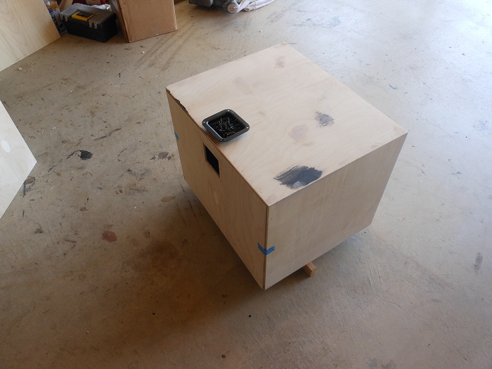

I'll start off with the mistake I made cutting the tweeters. As you can see in the photo I cut too much off. Got the calipers and calculator out and re figured. I got the saw set up to cut the right amount off. I'll have to repair the tweeter though.
All braces are glued and holes marked for drilling. I'm going to drill the holes before painting.
I decided to put handles on and realized I should have thought of that before I started the build. Some of the braces are in the way. After the holes were cut for the handles I made some splints to reattach the braces. I laid a piece of 2"wide x 3/4" thick wood on the floor, taped the back to the cab and put the input cup and screws on it towards back and balanced it on the board to find the center of gravity to locate the handles so that when I pick up the cab it will balance out.
The melded arrays are glued and drying as I write this post. For those of you who are going to build your own melded arrays make sure your cuts are spot on. It will save time gluing them together and test fit each tweeter before gluing. I had to do some sanding and trimming to get a good fit. Trust me it will look a lot cleaner when done.
