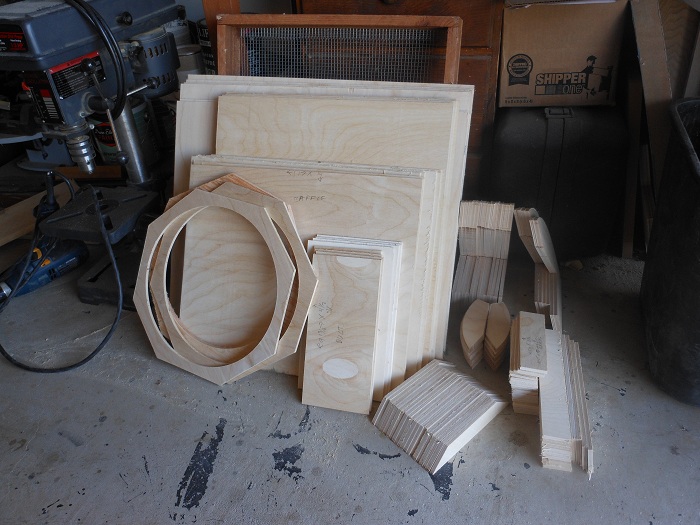

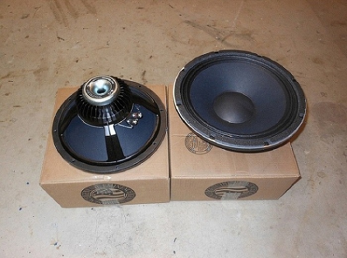

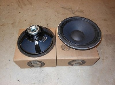

So, here we go . Got my toys today, two Eminence 2512's and started making saw dust. :hyper:

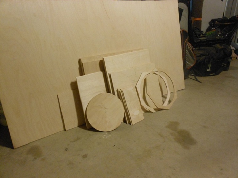

Spent about six hours cutting and still not done. I started making mistakes so I decided it was time to call it a day. I will continue tomorrow. Need to do the radius cuts (horn braces, throat braces, & throat plate).

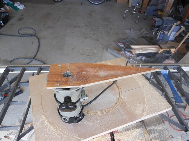

I think all parts are rough cut. Wow, there are a lot of pieces. Even going slow I made mistakes like not compensating for the diameter of the router bit so some parts were done twice.

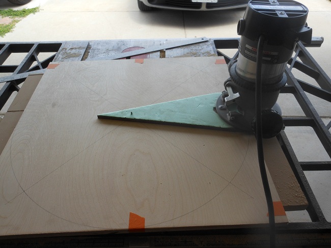

My Jasper jig only went up to 18 15/16" I had to make one to cut a 20" diameter circle.

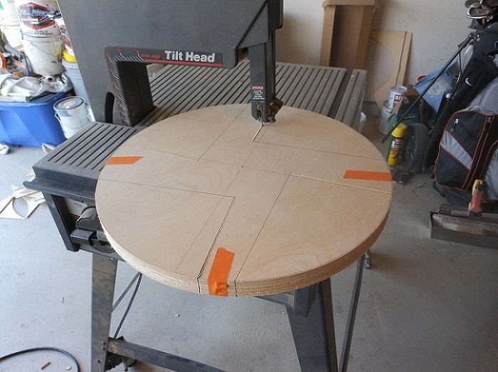

Since I'm building two cabs I stacked pieces to cut several parts at once.

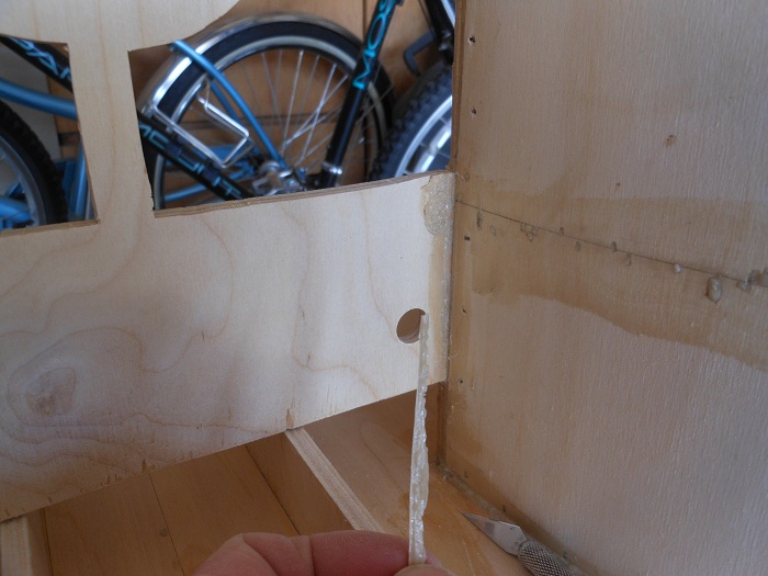

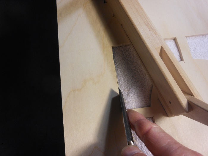

PulseMan. you asked for it. Got the assembling going. Had to clean up a few rough edges. Man, I like a sharp chisle. Things are moving right along. Tedward

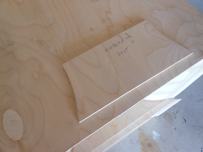

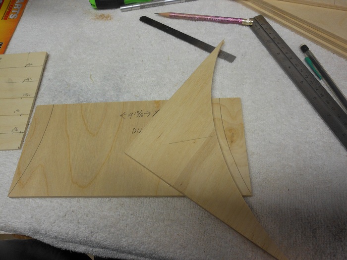

I used the scrap from the 20" circle to trace the radius for the ducts.
Drawing out the throught sheath

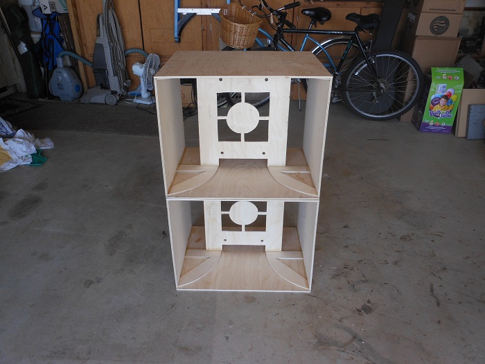

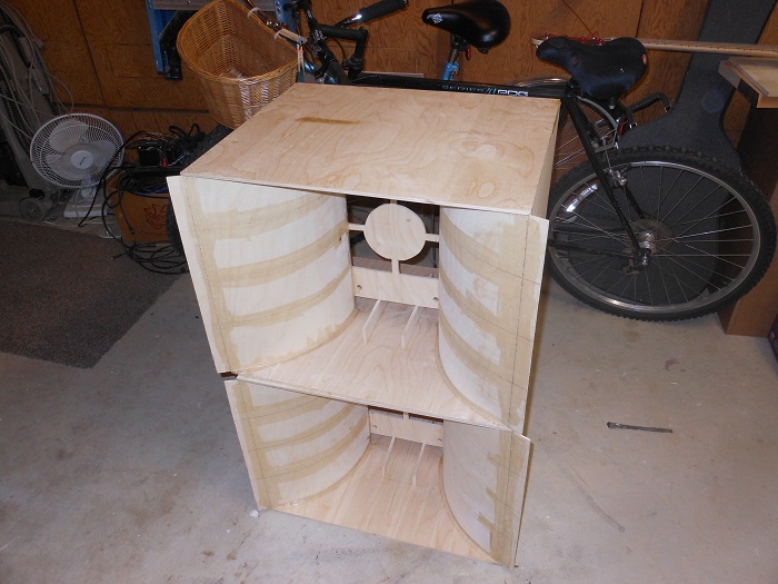

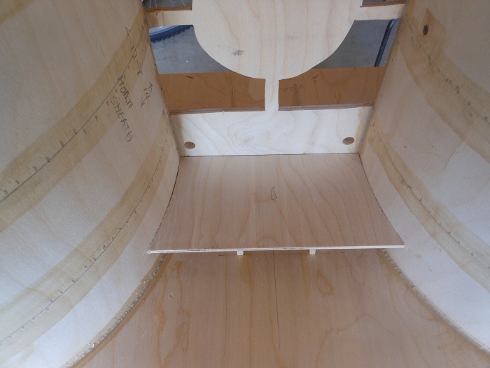

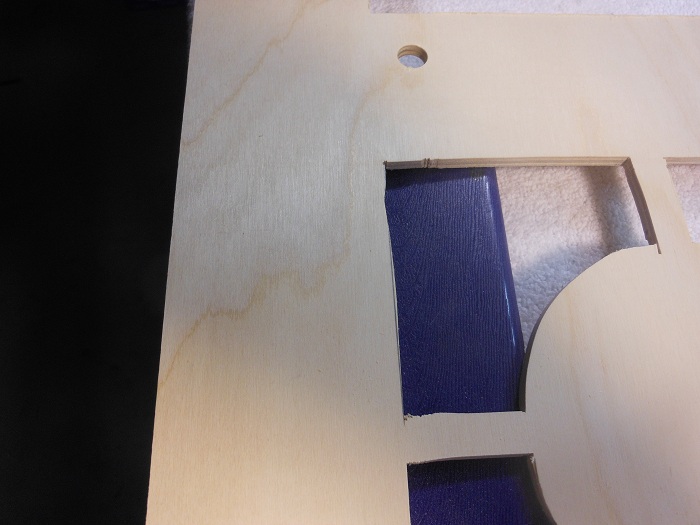

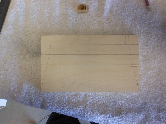

Ok, so after I got my daily chores done I got to play in the garage. Got the duct braces, the ducts, and throat sheaths in.
I am having a problem bending to throat sheaths, though. I used 1/8" birch ply and this stuff is stiff. I tried to bend them with steam and a bending iron but since it's plywood it was a no go. Is there a trick to bending this or should I use bender board?
For the time being more photos. :hyper:

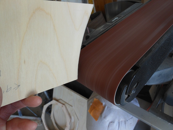

sanding the duct for a good fit
the duct glued in
the duct glued in

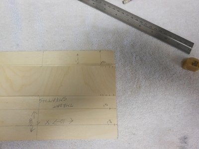

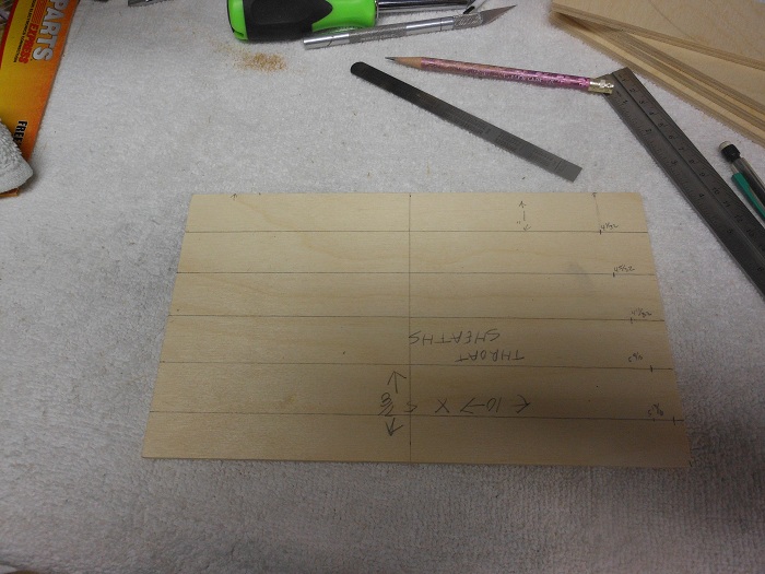

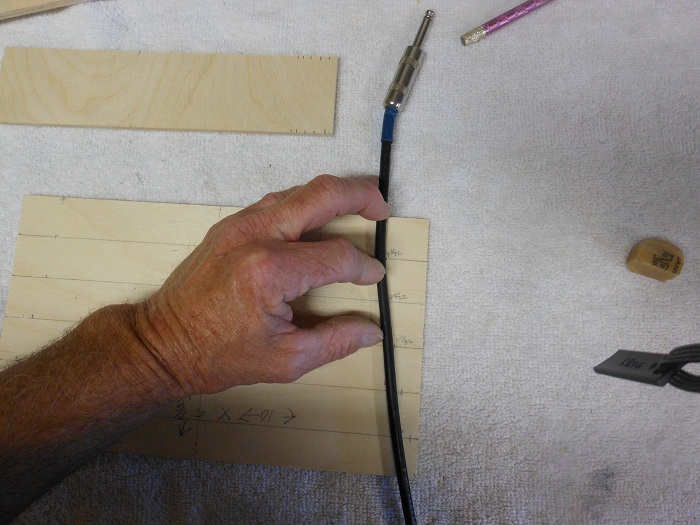

I made a jig to mark the rest of the throat sheaths
another use for a guitar cable (connect the the dots)
throat sheath layed out

cleaning up a little
the ducts were cut oversized
Only if you cut it on the wrong axis. I built mine with no steaming or special techniques, bending it into place with only hand pressure.

#15 Post by Tom Smit »
How in the world did you get the bikes squeezed in there???? :lol:
