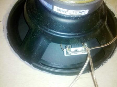

Wiring progress. Let me know if I did it wrong! It seems like 1.9 ohms is awfully low, of course its not in series with the piezos/crossover yet either.

It is too low. And the piezos are not in series with the midbasses.chenry78 wrote:Wiring progress. Let me know if I did it wrong! It seems like 1.9 ohms is awfully low, of course its not in series with the piezos/crossover yet either.

I'm not sure why they are reading so low..yeah I didn't wanna hook the piezos up until I figured out the deal with my midbass. Ill have to look at stuff tonigh, was gettin a little pressed for time last night.Bill Fitzmaurice wrote:It is too low. And the piezos are not in series with the midbasses.chenry78 wrote:Wiring progress. Let me know if I did it wrong! It seems like 1.9 ohms is awfully low, of course its not in series with the piezos/crossover yet either.

You're 8 drivers each 12 ohms. With a series / parallel hookup, you should be around 6 ohms.
To hook series parallel, wire the negative terminals of the first 4 drivers together, from the - input of the crossover/filter. Then, hook the positive terminals together and run that to the negative terminals of the other 4 drivers. Then, you hook the positive terminals from the remaining 4 drivers together and run that to your + input of the crossover/filter. That's two series banks of 4 parallel drivers.
Your piezos will be run separate from the mid bass drivers out of the crossover/filter circuit.

Thinking about your hookup again and what your photos look like, I suspect that all your drivers are hooked up in parallel
That is: 1/(8/12) = 1.5 ohms. That's pretty close to what you measured.

Thanks for your input Chris, and your right they were all in parallel! Im an idiot!gzc_stageTech wrote:Thinking about your hookup again and what your photos look like, I suspect that all your drivers are hooked up in parallel
Think that might be the case?
Chris
Like you im running the mids without a filter and thus should wire directly into the speaker terminal, parallel with the crossover/filter for the piezos.
See the pic for what I think is correct.

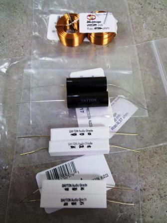

ok here is my crossover/filter for the piezo's per the plans. It should be correct, lets hope anyway!
also, if you guys have any recommendations regarding a crossover/filter for the midbass speakers, let me know. This is my first time with homemade crossovers and series/parallel wiring. Again, thanks for all your help Chris and everyone else. This might be the first set of speakers I have built correctly!!

Correct.
