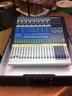

I bought Frankie G.'s Presonus 16.4.2 a couple of weeks ago. It need a place to reside other than the cardboard box it came in......
Sorry I didn't take photos along the way, I was in a hurry to get it finished - Using it for the first time this Saturday for an outdoor benefit.
Here it is.....

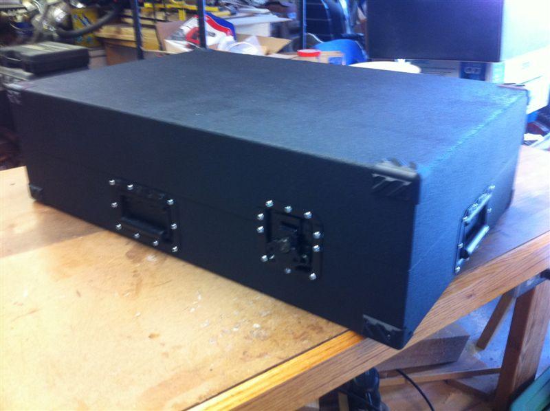

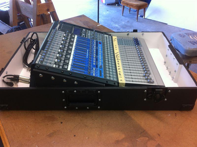

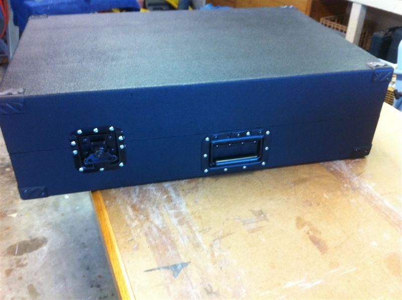

Hinged with come-apart hinges so the top can come off... Handle on on the front end for one-man carry, and handles on both side for two... Added side supports and rack rails to hold it in the position that I wanted.... And, because I'm so tired to chasing stuff in the dark, I painted the interior white so it's easier to see things at night.... Got a chance to finally play with the board some today. Easy to use and I think I'm really going to like it. Also, fired up the DriveRack PA+ that I got from Frankie and RTA'd the mains. Moved my old DriveRack to monitors and RTA'd the WH10s to see if I can get 'em sounding the way I want.
All in all, a good day - headed out back for celebratory Dos Equis, Cigar, and headphones.......
Here it is.....

Sides are 1/2" baltic birch that I had left over from other builds. The top and bottom are 1/4" ply from home depot. Wanted to keep it as light as possible. Weighed in at 22 pounds. Already had duratex and corners left over from other builds also.gzc_stageTech wrote:
How much do you have in yours?
Chris
With the plywood and hardware.....about $40-50.....and a bunch of labor. As I was carefully routing out for the handles and latches, my wife walks by and says, "It's just a box...".
Out of rubber feet though.....need to get some.
Starting to get a little obsessed with building it all myself.
Guess I should have added it to this....

Nope. Since the board is secured to the rack rails, there's no need. I had considered some foam to lay on top, but figured the only thing that could hit the board was air.......BoostFab wrote:are you going to fill it up with foam ?
