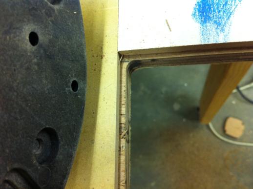

For no other reason than I felt it would give the speaker cable ends a little more protection, I decided to mount to jack plates on the inside of the back panel. This means I need a accurately cut hole or it will just look terrible.
I started by marking out where I wanted the hole and how big it was and then did a rough cut out with a jigsaw.

I then placed a template/collate guide (sometimes called a "bushing") on my router and 4 straight edge template guides on the back panel and routed the hole.
The only trick here is to place the straight edge templates the same distance from the marked lines as the router bit is from the outside of the collate. In my case it is 6mm.
Note: because the collate wont fit into the corners of the template guides you end up with lovely curved corners.

I finished off the hole with a round over bit but haven't taken any photos of that yet.
