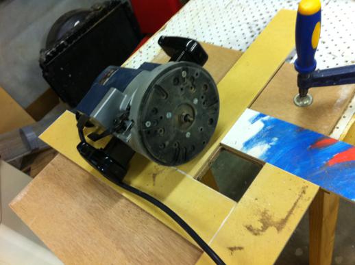

For no other reason than I felt it would give the speaker cable ends a little more protection, I decided to mount to jack plates on the inside of the back panel. This means I need a accurately cut hole or it will just look terrible.
I started by marking out where I wanted the hole and how big it was and then did a rough cut out with a jigsaw.
Stupidity should be painful
NeilD321
Posts: 112
Location: Kiama, Australia
Re: Australian Jack Stack
#36 Post by NeilD321 »
I then placed a template/collate guide (sometimes called a "bushing") on my router and 4 straight edge template guides on the back panel and routed the hole.
The only trick here is to place the straight edge templates the same distance from the marked lines as the router bit is from the outside of the collate. In my case it is 6mm.
Note: because the collate wont fit into the corners of the template guides you end up with lovely curved corners.
The collate/bushing
The collate/bushing
The setup. The template guides are simply panel pinned to the back.
After routing
After routing

I finished off the hole with a round over bit but haven't taken any photos of that yet.
It is also exactly how I routed the holes for the handles. It just took a little longer to make the curved template.

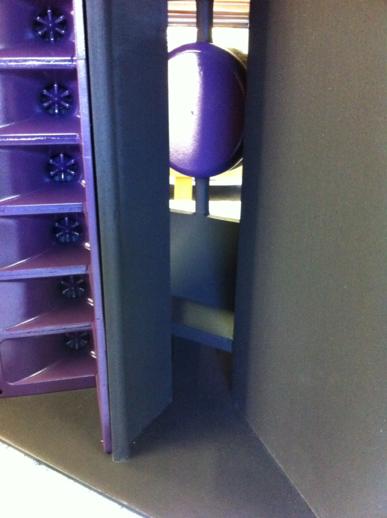

Here's a quick picture of the "fins" I added to the back of the melded array supports to keep the lines clean and prying fingers out as I'm not using a front grill.
jswingchun
Posts: 1073
Location: Cedar Rapids, Iowa
#39 Post by jswingchun »
NeilD321 wrote:Here's a quick picture of the "fins" I added to the back of the melded array supports to keep the lines clean and prying fingers out as I'm not using a front grill.
I'm looking forward to seeing how that looks when finished.

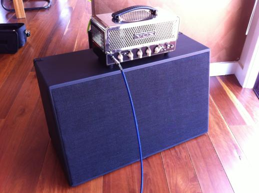

Here are some more pics
Trial fitting the melded array
A pair of nude Jacks on their stands
With some clothes on....
Showing the "Fins"
