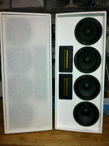

A. Is there room on the baffle to fit Dayton PT2C-8 Planar tweeters, even if they touch the drivers and the outer perimeter?
Not without a mod... but a mod well worth the effort. I believe it adds about 2 inches in width to the standard cab, and in the set I am having built, we made that change and kept the volume similar with extra bracing for flypoints... styrofoam in the cab would be just as effective. They can fit 4 of the tweeters, I spec'd two, as they will be single cabs per side, and 2 is plenty for the volume levels I need, plus I don't want laser beam dispersion... I wanted about 20 degrees, and this is what I expect based on the 16" hf section.. about the same as a DR or OT. If you were stacking them, you'd want four.

There's no real world gap. My DRs actually got louder and smoother when I made the change... this is probably a combination of extra chamber volume (no piezo horns in the array means more chamber volume), no passive crossover voltage loss, and the ability to take the individual drivers up to max safely.
The Dayton ribbons definitely work in the DR200, I know they will work in the SLAPro because I have a colleague that builds a similar cab this way (with the Dayton mids as well, which is what are going in my pair) and they should also work in J10, J12, and OT12 with 2 per cab (based on charts). I'd be hesitant to put only 2 in a DR250, 3 might do it, but they might not... I don't know. Bill said it took 6 when he tried years ago.
All I can say is I'm very happy with my DRs, and I know I will be with the SLAs. Those are for the church... I wouldn't be spending the church's money on them if I wasn't sure.
And.. hot off the camera... here they are (along with their 1/2 size sidefill brothers with 1005 piezos).
