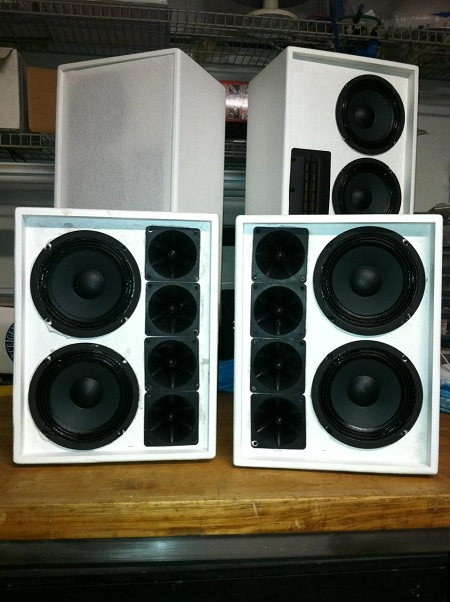

Not without a mod... but a mod well worth the effort. I believe it adds about 2 inches in width to the standard cab, and in the set I am having built, we made that change and kept the volume similar with extra bracing for flypoints... styrofoam in the cab would be just as effective. They can fit 4 of the tweeters, I spec'd two, as they will be single cabs per side, and 2 is plenty for the volume levels I need, plus I don't want laser beam dispersion... I wanted about 20 degrees, and this is what I expect based on the 16" hf section.. about the same as a DR or OT. If you were stacking them, you'd want four.Radian wrote:I don't have the plans in hand yet, so please bear with me....

And.. hot off the camera... here they are (along with their 1/2 size sidefill brothers with 1005 piezos).

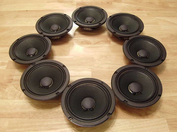

I'm in this deep so far:

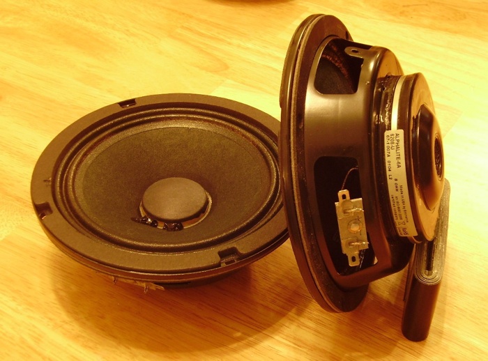

Yeah, same deal with those Alphalites in that pic. PE has the Alpha for about $40, Alphalite for $140. Yikes! Multiply that by 4 per cab and it really adds up.

Now that is a beautiful site to behold.Radian wrote: I'm in this deep so far:![]()
