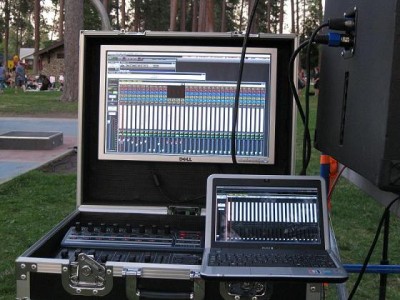

Head end of the SAC system.  Monitor and BCF-2000 built into lid of Audiopile large briefcase.

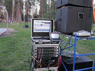

Mini Me.  Dell Mini 9

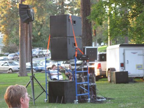

TOA HX5 for wide side throw.  will use just finished Jack 10s next time.

What's on the tripod in the bottom pic next to the stack?

#7 Post by BrentEvans »
James R wrote:What's on the tripod in the bottom pic next to the stack?
Looks like a TOA HX5. Not a bad little box actually.

#8 Post by Ken Lustgarten »
I am pretty sure that they are TOA. Now the question that remains is were the TOA's the main system and the DR's backup? :lol: As a side note I have taken apart a few TOA's and was surprised by the low quality drivers that they use. In one TOA rear fill a replacement PE driver that cost $5.00 was far better then the original.

#9 Post by BrentEvans »
Ken Lustgarten wrote:I am pretty sure that they are TOA. Now the question that remains is were the TOA's the main system and the DR's backup? :lol: As a side note I have taken apart a few TOA's and was surprised by the low quality drivers that they use. In one TOA rear fill a replacement PE driver that cost $5.00 was far better then the original.
The hx5s are relatively high tech for TOA. They were installed in a church I upgraded to SAC and I had no trouble getting good sound from them. The install there was less than optimal (3 in a trap cluster style array) but we made it sound pretty even by working with the variable splay. They dont go to rock band levels, but they work well as designed... and the built in hf protection circuit works quite well (although you do have to power down the amp to reset it). In a low volume church where things must be flown (and BF designs arent an option) they'reon my radar, anyway.
