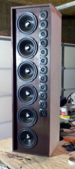

Are you looking to build a cab for backline use or FOH? It seems that you may be overthinking things a bit. Combining aspects of designs can be dangerous. You can very quickly end up with very poor results. Ewetho and I built many of Bill's cabs before we wandered off and built the one at the begining of this post. I would suggest you build a single SLA/PRO exactly to Bill's specs with the 6 tweet option. Try it and see how it performs.
However, If you must build something "Off The Reservation", let me fill you in on some of our experiences. We built the original SLA's for Ewetho's home theatre. They were so impressive; by impressive I mean smooth and accurate with excellent off axis response and great imaging. We had some 5" MCM mid-bass drivers laying about so we decided to see what would happen if we made a larger SLA with those. We used the same Goldwood tweets as in the standard SLA. We called this model the SLA Extreme. You can see it in the picture below next to our test model of a boolshelf SLA. We found that the 12 tweets were a tad bright against the 6 - 5" bass drivers but a minor dab of EQ brought the cab in line. The next idea was to move a bit more air and even out the cab so we went to the 6" Mid-Bass drivers. These were a perfect match to the 12 tweets. The cab at the begining of this post has the identical sound characteristics as the original SLA just louder and with a larger sound front. We compared them to my Otop15's with melded arrays. The large SLA (we call it the 612) has a much flatter response and needs almost no EQ. It also has a sweeter sound than the Otop15. The Otop gets louder on less power but at 400 watts the SLA is in the 120Db realm so we are happy. The Otop15 melded and the SLA are very similar in off axis response with the Otop having a slight edge but not enough to be a deal breaker. We like the large SLA for indoor use due to it's pattern control and sweet even sound. Watch and listen to the video from Radian at the beginning of this thread. We use the large SLAs for FOH, Back Line and Monitoring. The Otops are now strictly for Outdoor use (we use 2 per side stacked).
Bottom line: Build a large SLA, I STRONGLY suggest Bill's design at least to start. You won't be disappointed. Then if you want/need more just build more SLA/PRO's and stack or spiral stack as Bill has suggested.
Let me also address your idea of one large cab. I too thought this way. I built the largest cabs Bill had for my purposes and figured one large cab is best. I WAS WRONG. After hearing Otop12's at our listening party, for instance, I see the flexibility and brilliance of Bill's designs. Today I would not have built my 4 Otop15s. I would instead build 6 or even 8 Otop12's. The same goes for my Tuba subs. Today I would and will build Tuba 24's in quantity not Titan 48's or Tuba 36's or 60's. You are better off with many scalpels than a single sledgehammer until you get outdoors.

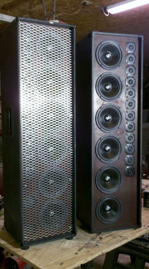

Re: SLA DJ/Pro style
Thought you might like to see NUMBER TWO.....
We now have a Right and Left and plan to use them in lieu of the OT15s for a school dance on Saturday.

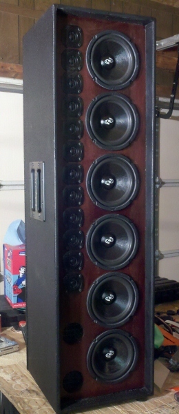

Minor finishing to go but they go to war Saturday Night!!!
Hat for the pole mounts are in and cab has been to war volume!
