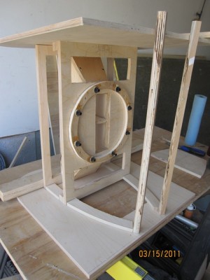

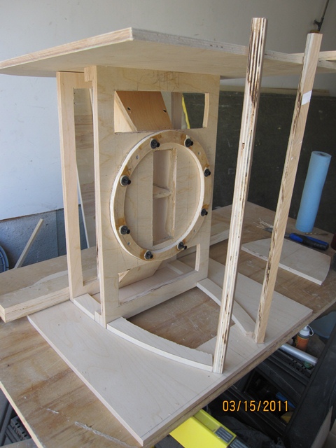

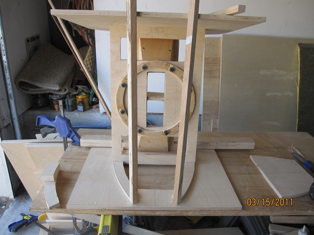

After long debate with many good review for DR250 so I decided to to go with it . It kind of confusing at first, so I took one step at the time cut all the parts first dry fit and it make sense . attached couple pics. Help me out if you see any mistake that I can correct at this state .
Ps : After glue the tweeters it measure 21 1/8 . In the plan said 21 in or less so what should I do .

Finish it. Extend the plate either at the top and bottom of the array cutout to fill the extra gap.

If you havent assembled those parts yet,you can adjust the height of the cabs by trimming according to the plans to make the cab tall enough in the front,acceptable height is 21-21 1/2 inches so you are good.
