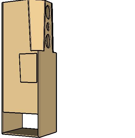

Are the Davids designed to be a Left and Right?
Meaning the exit horn?
Or do they both go to the left. Left as in the pic you provided.

I do believe the idea is to use them in a pair to replace a set of home speakers which I would like to do at some point in time. The horn shoots out both sides as seen here.chrapladm wrote:Are the Davids designed to be a Left and Right?

I had to try David in the corner of my living room.I'm tired of listening in the subwoofer "no-zone". I took a break from work and moved the piano and put David in the corner aimed at room center back wall. Connected my iPod to the Kenwood M2 and fired up the tunes. At 50 watts the sound was booming yet crisp and clean. At 120 Watts it was starting to feel like a rock concert and the house was shaking to the foundation yet still crisp and clean with no loss in detail. That's only one cab. Now I must build it's mate! I'll be shaking the neighbors house too....!
A couple of notes. I like big bass...not even EQ so the top section seemed a bit over the sub. The sub needed more power to get going. David sounds good flat but for my taste I added a bit of thunder in the EQ. I imaginge the bottom end wil get more powerfull with 2 corner loaded cabs.
The detail in the sound was so close to the SLA that these will be seing duty as stereo and HT cabs in my living room.
I will be rearranging the living room for 2 Davids in the corner with TV in the middle and SLA center channel with the TV.

Does the treble fall off when your out of the direct area like the SLAs?
I doubt it would, being that it isn't a SLA but I would rather ask.
That is what I was wanting to hear all along.
Davids for the front SLAS for the rears.

Explain? My SLAs that Steve and I built are very wide full dispersion and fairly minor horizontal falloff, but fairly narrow vertically. The David is fairly wide both ways now with our updated crossovers. However it does have a touch of noding vertically more of a problem when you pass through it that sit in the week spot. Very minor issue now but is noticeable in critical listening. If you just happen to be sitting in the bad spot you probably would never notice.chrapladm wrote:

Have not metered yet. My ears tell me that the MTM section is even to it's self but is hotter than the sub. Remember, we changed Bill's crossovers to eliminate nodes. this gave us a hotter MTM. The system can be brought back in balance with some EQ. It seems that the sub can still take more power when the MTM is at it's limit. Still need to work that out but it's minor IMOchaywood wrote:baronvonsteve wrote:I tried several sources with the same results.
Thanks, guys, but the MTM section is a bit hot for my taste but no complaints.

Re: David - Just For Fun
I was just talking about vertical dispersion so thanks for clearing my question up.
Seems to be a real performer.
