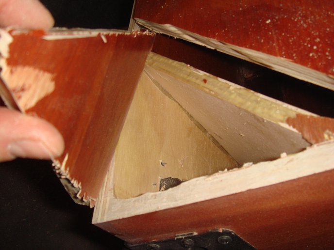

I've been building a T-60 for the last, say, 6 months. (Very inexperienced builder here. It's all learn as I fail.) 27 inches wide with a LAB 15. I finished the build, and ran it, and I THOUGHT it sounded pretty amazing. But after a day or two, once the gee whiz factor decreased, and more critical listening happened, I noticed a rattle. Initially I thought it was room resonance, as my house is small and the room it's in is about 9x11. Eventually, I found that applying pressure to certain spots on the side of the cab eliminated the rattle. Since I didn't think finding someone to lie on the cab every time during use was practical, I knew it had to be fixed. I thought maybe that the brace between panels 3 and 8 might not be glued into unison, so I drilled a pilot hole through panel 8 and fished a narrow wire through, and swing the bent over end around to feel what was going on in there. Sure enough, I had forgotten to re-install a portion of the bracing there that I had removed to bring the cab closer into square. (The kerf removed with the sonicrafter x2 was about enough to do that.) So now I have a missing brace. Now I got the pleasure of ripping apart a cab assembled with PE. I set the circular saw to a cutting depth of 1/2" and started plunge cutting. And cutting, and cutting, and cutting. This is tricky: if you don't start at the edges and work your way inward, you don't have anything of existing height to rest the saw on for proper depth. Eventually you get to about nothing left to rest it on, so I took left over chunks of 1/2" plywood and used those. Running the saw back and forth sideways acted as an ad hoc router, evening up the surface. BUT, it still doesn't leave you with a nice even surface to glue back to, once you prep YET ANOTHER end cap. (I'm sanding, staining, and sealing, not dura-texing.)
So here's where I am now: when I put the newly prepped cap on the side, the interior walls of the cab do NOT reach it. Even with 10 gallons (83 lbs) of water in a cooler, and 115 lbs of plate weights, the inner portion of the panel has a disconcerting gap. The gap is at the outer limits of the PE's expansion capabilities. I have already spread a layer of PE on the very lowest parts and let it dry, to shim it up some, but once I laid the cap on, it still looks to big to chance it. Here's what I've come up with so far:
1) Add more layers of PE to shim. (Due to staining and trying to keep this looking marginally professional, the extra layers of PE will probably make the inside view of the throat look like @$$.
2) ACTUALLY shim with a 1/4" or so layer of wood. Where do I get this? How do I make it myself? Will this ALSO look like @$$ ?
3) Lay the cab on its side, and use the circular saw to just take a kerf worth of wood off of the outer panels as needed, effectively raising the inner panels by comparison. (Most likely to be successful, also most likely to fill my house with MORE sawdust in my spare bedroom. Note to self and others: sawdust in the cold air return= furnace self shutting down. Make sure the shop vac's filter hasn't fallen off inside! ) And then continue on with gluing the last panel with PE?
Any other options I'm not coming up with?

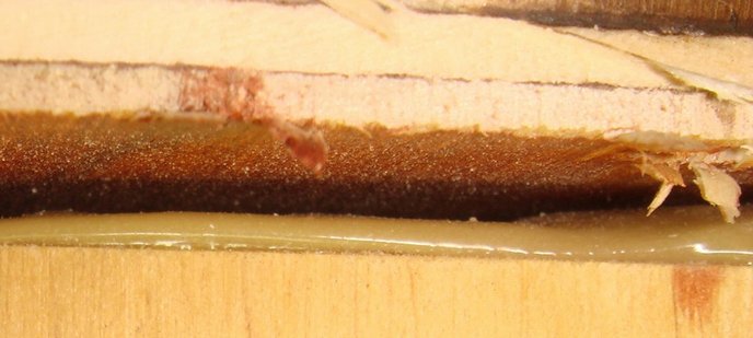

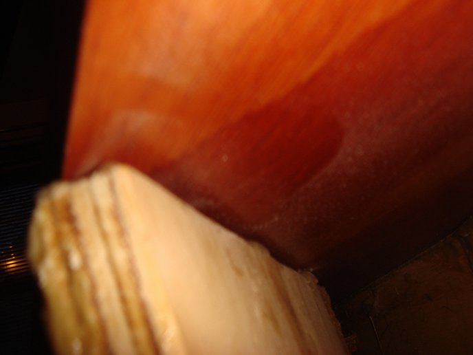

I could not believe how many places the PE didn't bridge the gap between panels.
Still haven't decided on how to go about buzzing down the sides: haul the thing to the front porch in the snow, or once again fill my spare bedroom with sawdust.
No matter HOW much weight I applied, it wasn't enough to close the gap. And that cat is HEAVY!
Lots and lots of areas with totally glossy PE, never touched NUTHIN!

That is stained and polyurethanes auruco plywood. In the places where the panels came close, and the PE was sufficient, adherence was no problem, only where the gap exceeded the expansion capabilities of the PE. In those cases, I got nothin!

Well I ended up removing the final side panel via death by circular saw. I set the depth to a hair under 1/2" and just plunged and plunged till I couldn't plunge any more. And then I did. It was a super pain in the a$$, but it had to be done. I got a fresh / unwarped piece of Auruco (when it's new it's not a bad plywood), sanded, stained, and PL-ed it in place. Didn't need anywhere near as much weight as I did with the warped piece. And I used a bit more PL to boot. Gave it 2 days to absolutely cure, and badda bing, I was in business. The sound is amazing, as well as house quaking. Now I just have to figure out what tops to build to match, without them being completely out-gunned by the T-60. I'd like to play to a big room sometime; the one I have in mind is about 60x80, with 25 foot ceilings. Any suggestions? I'm thinking 280s or 300s.
