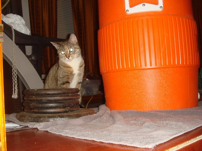

So here's where I am now: when I put the newly prepped cap on the side, the interior walls of the cab do NOT reach it. Even with 10 gallons (83 lbs) of water in a cooler, and 115 lbs of plate weights, the inner portion of the panel has a disconcerting gap. The gap is at the outer limits of the PE's expansion capabilities. I have already spread a layer of PE on the very lowest parts and let it dry, to shim it up some, but once I laid the cap on, it still looks to big to chance it. Here's what I've come up with so far:
1) Add more layers of PE to shim. (Due to staining and trying to keep this looking marginally professional, the extra layers of PE will probably make the inside view of the throat look like @$$.
2) ACTUALLY shim with a 1/4" or so layer of wood. Where do I get this? How do I make it myself? Will this ALSO look like @$$ ?
3) Lay the cab on its side, and use the circular saw to just take a kerf worth of wood off of the outer panels as needed, effectively raising the inner panels by comparison. (Most likely to be successful, also most likely to fill my house with MORE sawdust in my spare bedroom. Note to self and others: sawdust in the cold air return= furnace self shutting down. Make sure the shop vac's filter hasn't fallen off inside! ) And then continue on with gluing the last panel with PE?
Any other options I'm not coming up with?
