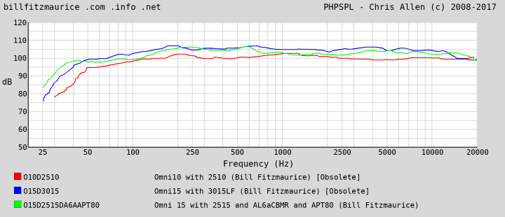

Omni 15, Deltalite 2515 loaded.
And, remember that the Omni 10 chart is 4 Ohm, while the Omni 15 is 8 Ohm!

I'm not a bigtime graph-reading expert...
And of course the chart is comparing the O10 to 2 flavors of O15.
Does it suggest (I'm looking at the relative parallel-ism of the curves) that the obsoleted O15 (with the 3015LF) would sound a lot like the O10, only louder and with more low end?
The newer O15 graph is less parallel (but with still stronger low end).
