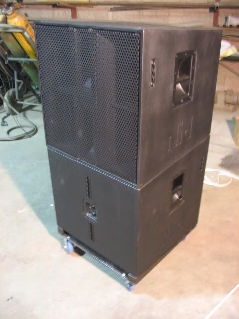

Speaking of transportation (sorry for the slight hijack...) this is what I made for my DR290s.
Castor boards with blocks to match the bottom angle of the cab (and seats for the cab's feet)
Each board takes two cabs and a custom padded cover with ratchet strap holds the whole set nicely together.
The castor boards:
Two DR290s stacked on the castor board:
Covered and strapped:
