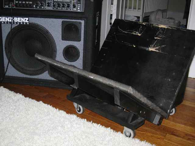

You're in the same boat as I am - I love my combo amp (it's an older GenzBenz 250c 1x12). My combo amp is a small version of a bigger one (250 watts v. 500 watts at 4ohm) and there are places on the circuit board that are half-empty. I've thought about trying to modify it, but in reality, there's no way I could get my hands on the right parts or know for sure how to do it.
I imagine that part of the sound you like is the cabinet itself. You can get the most out of what you have now by always corner- or wall-loading it and pointing it up at your ears. What I did is build a tiltback stand with wheels. I got the idea while watching the Grand Ole Opry with grandma and seeing the front line of musicians' amps facing back towards them, on black stands to keep them discreet on stage. Anyhow, this points the amp up at my ears, and I have a one-trip load in, because of the wheels. When I need a lot of volume (like practice with my rock band) I roll it into the corner or against the wall and the low-end gets acoustically coupled for additional bass.
I also had a desire to make it sound even bigger for outdoor shows (normally I'd have a PA, but one band is old-school.) I ended up building a Titan 39 sub for bi-amping. The signal goes from the combo head to the sub, where the passive crossover sends the highs back to the combo speaker. The combo speaker is no longer putting out the lows, and so it doesn't run out of steam as quick. The titan with the passive crossover (less precise than a digital or active crossover) sounds good with bass guitar, and gets lots of low end that wasn't there before. I play a 5-string G&L bass. It shakes the rafters in the church gym. (The picture is taken before I added the final braces for the mouth or covered it in duratex.)
Another thought that might work, though I have to admit I don't have a lot of experience with one, is a compression pedal. From what I understand, you can raise your effective volume level by compressing the signal. Maybe one of the forum's experienced pro's can help with that.
Here's all my old photos to help you understand what I'm talking about.
BASS: Combo Amp & Titan39
