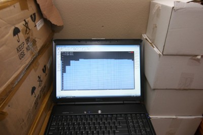

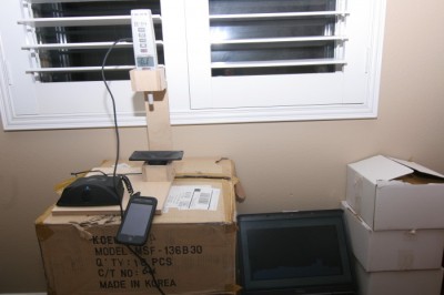

Pic. 1 Just got all the parts in and from your PM's and your video I was able to figure it out with no problem and came up with this test rig
I used the dayton T-amp for my source (on sale) and an iphone app for the test signals, an spl meter for the mike (I wanted a good one anyway)
Pic. 2 Look at the pink noise, it does not look like yours, has a peak?

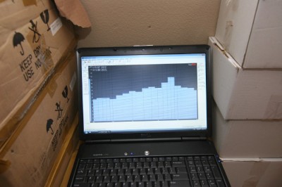

Pic. 3 here is a sweep with the peak hold on for the pic (some of the lower freq. was noise from me, sensitive mic I guess?)

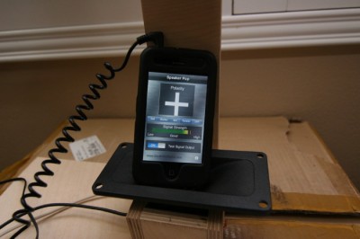

Pic. 4 This is another app that is supposed to check for correct polarity called speaker pop, it sends these clicking noises and either gives a + or a - sign only thing is it showed mine was reversed, is this common? have only tested one tweeter, I just wanted to get this set up for now so I can't compare this graph to others yet

tested all 72 of them and found that 44 of them tested at the high end of the output range or 94+ db while 16 of them were around 92 db and 10 of them around 89 to 90 db while 1 was at 82 db and another had little output in the 2 to 3 khz range as far as the phase test it does not seem to work as all tested were exact opposite
