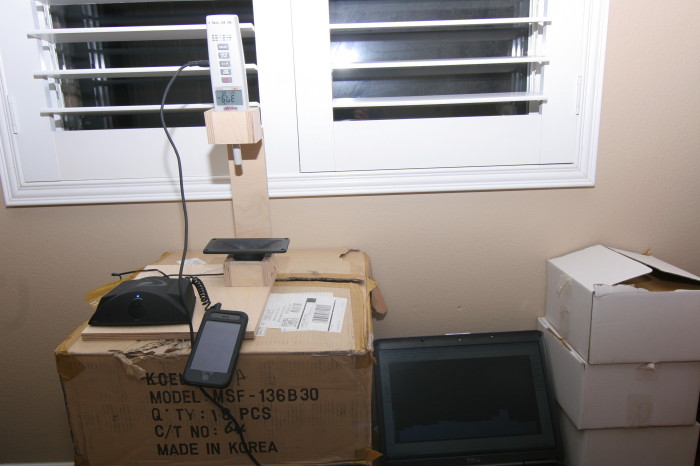

Pic. 1 Just got all the parts in and from your PM's and your video I was able to figure it out with no problem and came up with this test rig
I used the dayton T-amp for my source (on sale) and an iphone app for the test signals, an spl meter for the mike (I wanted a good one anyway)

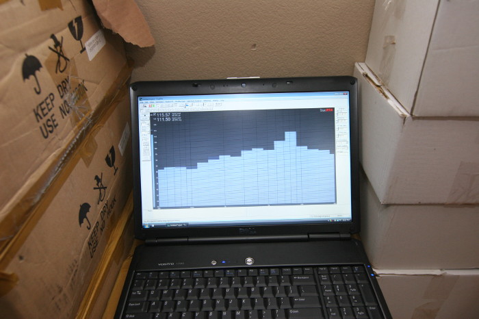

Pic. 2 Look at the pink noise, it does not look like yours, has a peak?
Pic. 3 here is a sweep with the peak hold on for the pic (some of the lower freq. was noise from me, sensitive mic I guess?)
