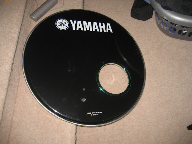

I got a new acoustic kick for which I was putting a new port in:

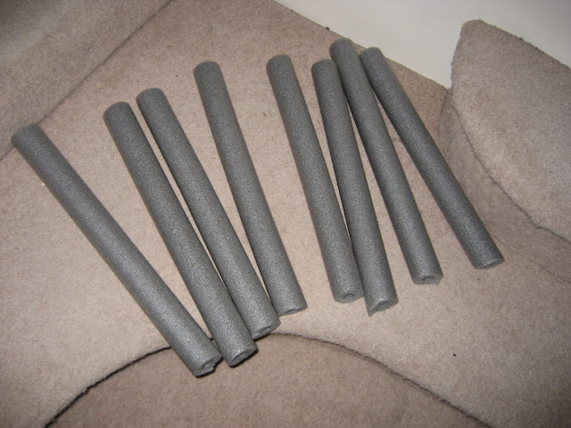

I found some of this in the garage, pipe insulation:
so I cut some to length:

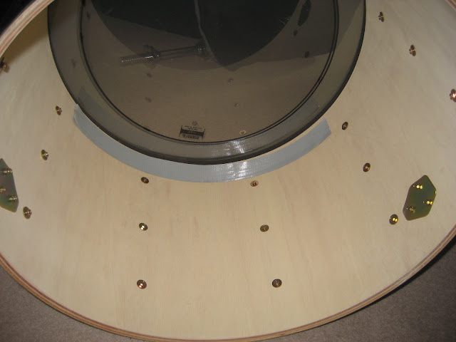

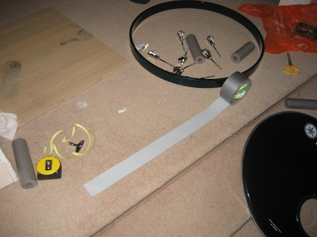

a little bit of gaffer tape:
inside the drum:

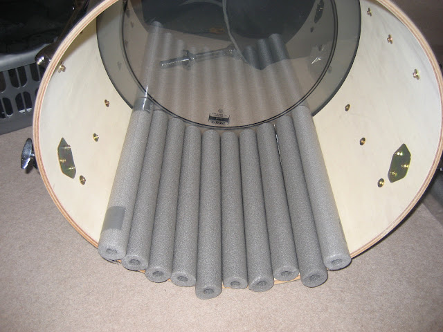

and I placed the insulation
they needed a bit of a trim to be the correct length, but I put the skin back on
The end result is that it never moves, it dampens both the skins, it doesn't interfere with the kick mic, you can put in as little or as much as you need, it's dead cheap and not a permanent change.
The sound is great and I couldn't be happier.

Does it touch the heads at all and if so how much pressure?

It regard to the appearance, Scott's right, the audience can't see them, so why bother.
The overhang from the edge of the shell was around 3/8". Quite a pressure, but works fine. I cut them large so I could trim them but since there is no problem, I didn't bother.
