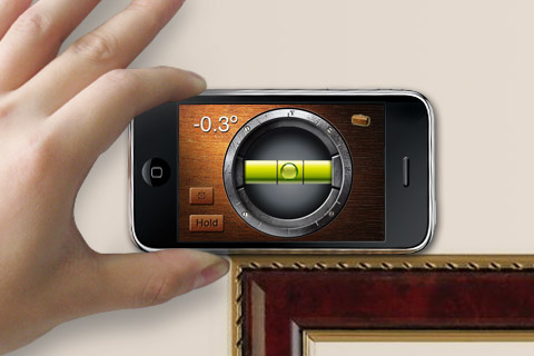

DrDoug018
Posts: 222
Joined: Fri Jun 30, 2006 11:51 am
Location: Dublin, OH
Re: Small Angles with a Circular Saw
#12 Post by DrDoug018 »
tammojsmit wrote:I use this one... http://www.amazon.com/General-Tools-Pla ... B00004T7P5 and it is dirt cheap! I set it on the saw bed, and against the blade. Then I adjust the bed to the angle desired.
As mentioned, PL will fill for a square cut (if PL is available).
My approach is "Why use an inexpensive straight-forward tool when much more expensive and complicated options are available?"
I have both but it is just so much more rewarding to use a phone to build a speaker. :ugeek:
