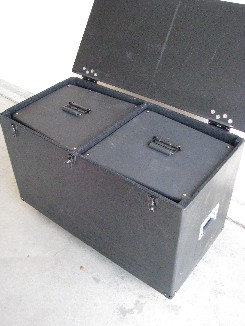

Thanks, Harley. I found something similar for indoor/outdoor carpet in the flooring section of the store. It works, but does the smell ever go away? After two weeks it's still outgassing.
- Attachments
- DR200RoadCase.jpg (22.34 KiB) Viewed 5433 times
