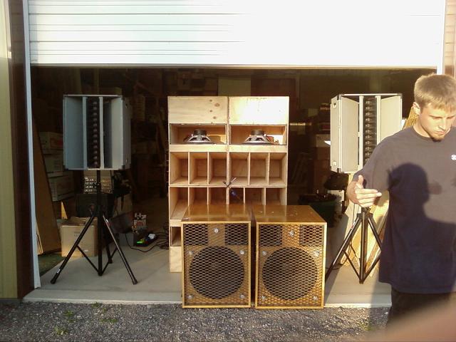

Re: FINALLY, RTA trace of half of WiSound(4xTHT, OTop 212s)
WiSounds wrote:
They were in an open garage door facing outdoors, not sure how that would impact the gains from boundary loading and cabin gain, but it was definitely not a standard or optimal setup.
The pic above was last spring when I went over them, I think Tristan nailed a pic of what we were doing... I'll see if I can grab it and throw it up here.
For a half-space result measure in an open field at least 200 feet from any buildings.

If this still has any bearing:
I believe that was Wi getting out his ray-gun to some DnB.
"It would take at least 16 T36s in half space to flatten the response all the way down. With boundary loading, less. With boundary loading and V coupling, less still. Add in cabin gain, again less. Wi's THTs as measured have both boundary loading and cabin gain, his result is not even close to that in half space, so it can't be even remotely compared to the same number of T36s in half space anechoic."
