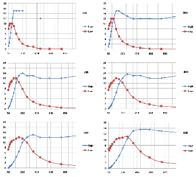

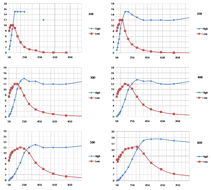

Thanks WB and Bill for the help. I ran the sweep and the crossover seemed to shift but I was not clever enough to figure out how to automatically capture the data. Therefore I manually measured the voltage from the top and bottom amps while applying the various frequencies. Here's what I got.Bill Fitzmaurice wrote:Just run pink noise into the amp and do the frequency sweep. The shift of the crossover frequency, or lack of it, will be very obvious.DrDoug018 wrote:
Can I simply hook up the top amp (then later the bottom amp) to my little analog volt meter and measure the voltage as I sweep the frequency?
Seems like the crossover is working but is not very accurate above 100 Hz or so. As I increased the dial from 100, 200, 300, 400, 500, 600, the crossover increased from 100, 125, 175, 225, 275, 325. Also seems like the slope is sorta shallow but I have not calculated it yet (not exactly sure how). At any rate, it seems like an awful lot of the frequencies I will be playing on bass will be provided by both the top and bottom cabs and I'm not sure how that will affect the clarity or sound.

With the O10 as a top you don't need a very steep slope. Just set it where it sounds best.
