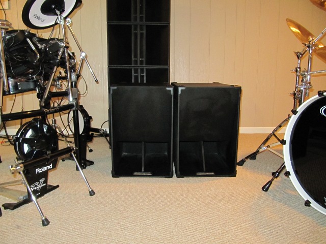

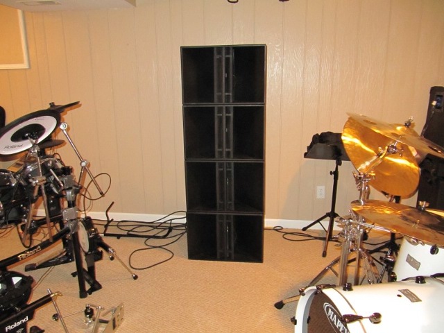

Hi guys,
Just figured I'd post a quick review on the cabs I've built.
So far, only 6 - 4x OTop 112's and 2x Tuba 24's. The build for 2x T48 30" started today, will probably take a week or so.
So far, I'm really really happy with the OTops. They sound really clear, not overly bright, seem to have a pretty good dispersion pattern, and get really really loud. I've set my limiters at 30v and it's actually hard to be near these things at 30v. Even 1 cab is very loud. They seem to get louder than a JBL SRX 722 with the same input power. When I stack all four up, they sound REALLY really good. Two definitely sounds better than one. I'm sure it has to do with the frequency response smoothing out, as I haven't had time to EQ them. Bottom line is they are a totally killer cab.
On to the Tuba 24's. At first, I was disappointed. I chose the S2010 driver without having the plans, so I'm not sure if it's the best driver for me. I didn't break it in either, shame on me. I've had them built for about a month now and have used them several times per week. I think the drivers are starting to break in because they are really solid. Running them with a limiter set at 30v - 12db bandpass gain, corner loaded and V plated - they actually fill my room with bass. Enough to make you think you have a pair of double 18" front loaded cabs.
I have a pair of JBL SRX 728's - and while honestly the Tuba 24's are as not strong, and don't go as low - they hold their own pretty well. I can easily fit the tuba's in my Envoy without a trailer, move them myself, etc. They aren't the strongest cab or anything, but I'm actually very satisfied with them. I can't say enough about them - they really do a great job.
Anyway, I don't quite understand how to measure the frequency response of the cabs - I get the overall, but if someone wants to post a test plan I will do it with the OTops. I know a few people are interested in the NSD version.

Is that a electric drum set on the left?
Wow I played an electric drum set awhile back when I was at Guitard Center and it was through a JBL 18 sub and some sort of single top and the sound was amazing. I loved the sound. Every time I would play the kick drum you could really FEEL it.
So I am wondering are you playing your drums through that setup?
I am wondering how that would sound if you were. Makes me want to build a top and sub for my drums in the future.

Ha Ha that's not an electric drum kit....
Nice looking speakers though - I would have expected the OT's to completely overrun those Tuba's. It's a shame about the driver choice, but I can guarantee you won't make that mistake again!
I still think that the 30" wide T48's are excessive and 24.5" would be fine.
I need to record a vid of my Roland though my BFM's.

The plans do specify that you should not use the S2010 unless you've got at least two 2x10s or four 1x10s.Adam Schaible wrote:
				Adam Schaible
 - Posts: 317
 - Joined: Sun May 24, 2009 9:02 am
 - Location: Cincinnati, Ohio
Re: OTop 112 / NSD 2005 and Tuba 24's
Yeah I bought the kit before having the plans, I just figured more $$ = better.  I built the T24's just to get my feet wet - I expect to store them away after the build because I didn't think they would be worth anything.  Now I must admit, I am very impressed by them.  They do great for my band practice - our bass player doesn't worry about an amp.
I'm not sure how much better the different driver would be. They are very solid for their size/weight.
In the background:
Roland TD-20. I did a gig last week with 4x OT112 and 2x JBL SRX 728. Sounded great.
Electric kits are nice. I kind of prefer my acoustic kit but there are situations where the electric makes more sense - especially in low volume situations.
In the background:
