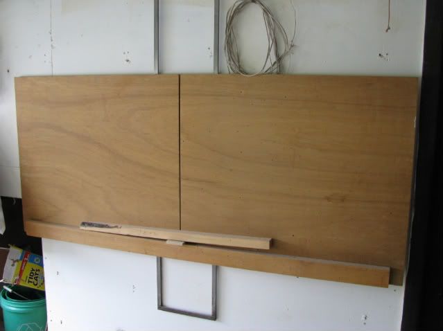

OR you can make a larger cross cutting jig using both channels in the table saw.
I'll take some pictures later and post of a large one and a small one.
The larger one will take a full 4x8 sheet and cross cut were ever with ease.

OK Harley it isn't pretty but it works. It slides on over the blade and the full sheet will just sit behind the blade (are you still there?)
When the cut is done you have to shut the saw off and slide back. It gives a very clean cut and perfect 90 degree from the straight edge. Never mind the peice of oak sitting on the straight edge.
Only downfall is that it is god dam heavy.
Good thing is that one person can cross cut a full sheet with ease, well for me it is.
