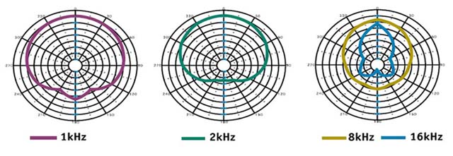

I use hypercardioid mics (OM6) which have the deaf spot at 120 degrees.
This angle is pretty close to where the wedges sit on the stage.

* I haven't heard both mics side by side ( I have heard reports ) So...
I took the liberty of clipping out the polar plots from the OM6 spec sheet pdf.
http://www.audixusa.com/docs/specs_pdf/ ... 0Sheet.pdf While the OM6 is a popular mic; It does not offer the 180 degree rejection null of the old workhorses SM57/58. Their patterns are very close to pure cardioid.
http://www.av24.co.kr/product/detail/sh ... _polar.gif
http://www.soundonsound.com/sos/jan08/a ... 0108_2.htm
These Shures mics ( while not as sexy as newer mics ) are like claw hammers, they do what they do dependable, even if they are boring.
I would suggest letting the "kiddie bands" use/abuse these mics.
