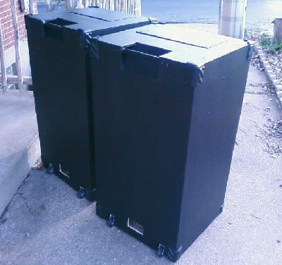

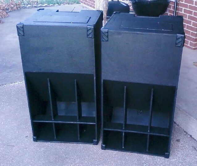

O.K. I just couldn't wait as I write this on my phone.I am finally finished with my Titans. Start date was 11/20/08, 2 20" T39 3012LF, finish date 3/31/09.Thanks to all on the forum. The knowledge base here is huge,so read often. Thanks also to Speaker Hardware. First off my carpentry skills are shotty at best,but I have access to proper tools and I am learning how to use them. Duratex finish makes them look very pro and it is very durable. Alright now for the sound. After checking for leaks I couldn't wait to hear'em. I used a cd player,Behringer mixer, Nady xover and EV amp.Recorded music random top 40. No top boxs.You get what you pay for on xovers. Minus some HF bleed thru the bass is LOUD & CLEAR. First 1 at a time then together. Even in my basement it was way obvious the difference of boundry loading, almost night and day. I can't wait to Vplate and test live.I have pics I will post later.They will be paired with JBl dual 15's for tops until I build my DR200's. I have a show next month and I'll cotinue my review.BTW these are replacing 2 18" 750watt direct radiators.

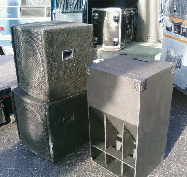

So far in my basement the sound is very punchy and clear.It really is deceiving how loud it really is without measurement.From past experience i am used to hearing low end distorsion from the 18's. A big muddy mess of frequencies that overwhelm the body and ears.That is what a some of my audiences ask for :roll: not knowing the difference.The thing I am looking forward to is being able to talk to the person next to me and hear everything on stage loudly.
I have also noticed if your within 4' of the front(not boundry loaded)they move enough air that you can feel it.
I gained some pack space on the footprint, and lost about half the weight. :hyper:

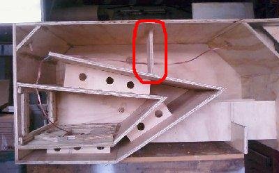

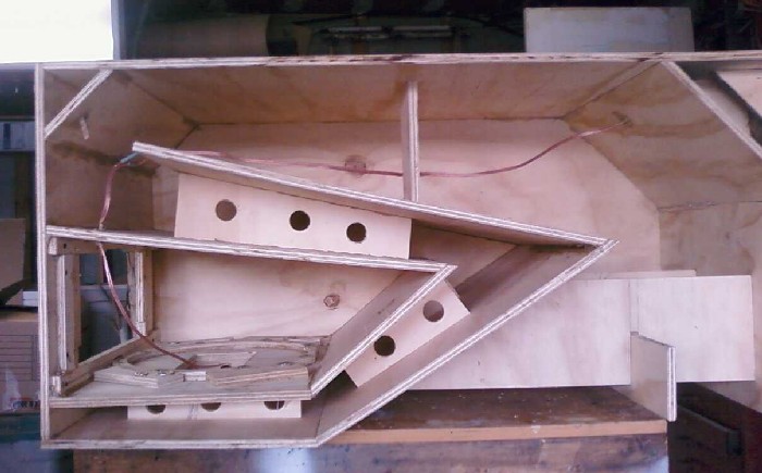

Sweet work, but is this right???

#6 Post by Haysus »
yeah o.k. I said I'm not the best carpenter or follower of directions. I realized what I did after I sealed them.BFM are very forgiving and if it bites me later it's ok I want to build more and learn from my mistakes.BTW i didn't mention the problems I had along the way. I F**ed up more than I like to admit but they sound better than my18's. I hope my DR200 build is better. Good eye, keep the patrol comin I need all the help I can get. Sorry for any errors I am Posting from my phone cause the desk/lapis not so good right now.

#7 Post by bgavin »
With a little patience and agility this can be rectified if need be.
It is the back panel that is insufficiently unbraced.
If you get a buzz, this is the cause.

bgavin wrote:It is the back panel that is insufficiently unbraced.
Depending on how wide it is, it'll also act like a blockage. I'd fix it.

#9 Post by Haysus »
That piece was a temp and not glued. I am going to fix it this week. :wall:

#10 Post by Rickisan »
Yeah wow, luckily it looks to be in a spot close enough to the mouth you can fix it one way or another. Good deal!
