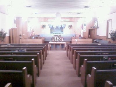

Something happened last week that really floored me. My pastor approved an audio budget! This is a big deal for us, as the last major investment in our sound system was fifteen years ago, when they paid a "pro" to come do a complete install (something to the tune of $12k, I think). In any case, no major investments since then, and things are starting to, well, degrade. I'm going to be upgrading to a SAC rig (Thanks, StevenGenter!) and I may have the budget to replace the main speaker with a BFM system. I want to do this if it's at all possible, and I'm being given a fair amount of control over the project (which I should, considering I'm the piano player, the bass player, the sound man, and the music director, sometimes simultaneously). Currently, it's an OAP 15+horn (as pictured) and my "sub" is a thirty year old Peavey TNT130 bass amp being powered through its auxiliary speaker jack (the head is so dirty it's unusable). The "sub" (I feel so guilty calling it that) was my desperate invention to clean up the sound coming out of the mains for zero money. Believe it or not, it works well enough (wall loaded it, crossed at 80hz). It does exactly what a sub is supposed to, you can't tell it's there until you unplug it, but it's right behind my playing position, and I hear ALL the distortion. Overall, I can get more than enough volume, but the system has its fair share of squeaks and squawks (like when the pastor walks right in front of the speaker, as he's prone to do). I also have to EQ the snot out of it, as the speaker is horribly peaky. The room is 40 x 60 or so.
The normal suggestion solicitation question is applicable: Which cabs, placed where? Bear in mind that things need to be aesthetically pleasing to keep the senior saints happy. :D Program content is piano/bass/vox/choir and speech. EVERYTHING goes through the system. No amps allowed.

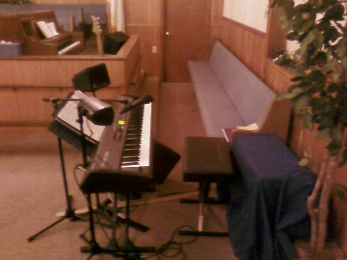

Horrible Quality Pix:
Stage Area:
My keyboard hole (the "sub" is draped in blue behind it).
[attachment=3]PIC-0051.jpg[/attachment

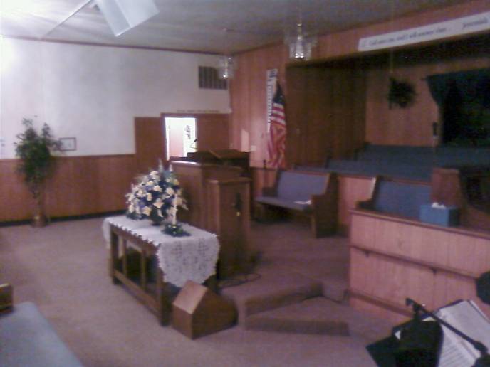

I don't know, guys...what do you think? How about a pair of DR200's w/melded arrays hanging in about the same location as the current cab? And then a T39 under the bench that is behind the pulpit/front of the choir? or are the short walls on either side of the pulpit going to inhibit the sound? A pair of WH's?
Brent-the short walls...is it possible for them to come down? That would open up the "stage" for skits, guest groups, etc, etc.....

tammojsmit wrote: And then a T39 under the bench that is behind the pulpit/front of the choir?

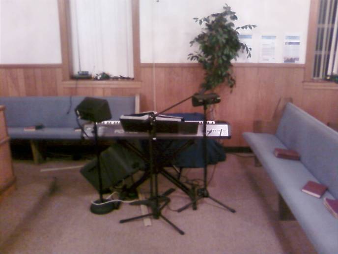

Benches only have about 36" clearance side to side, and about 13" top to bottom. There is space, however, beside them, and I can move the pew beside the keyboard to corner load in that corner (didn't sound good with the existing "sub" but I dont' discount it). Could also go under the communion table if I make it look nice (I'm thinking white duratex and white (or blue) grill cloth).
tammojsmit wrote: Brent-the short walls...is it possible for them to come down? That would open up the "stage" for skits, guest groups, etc, etc.....
That would be a major remodel, and remove the handrails that some of our older folks need to hold onto to get up from the altar area. Also, those things never happen, so no justification for a major remodel.

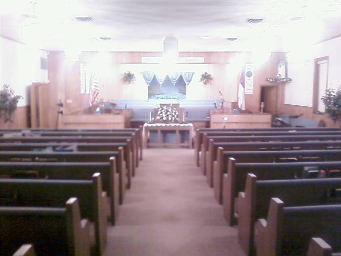

TLAH Pros on the rear wall, to the left and right corners. Pretty much just like those shown here:

Bill, would the TLAHs work just as well if I put them closer to the frontline of the stage? There's an air return and a lighthouse in the locations you described, can't move either.

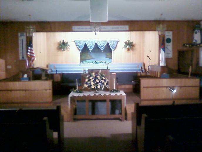

BrentEvans wrote:Bill, would the TLAHs work just as well if I put them closer to the frontline of the stage? There's an air return and a lighthouse in the locations you described, can't move either.
I'd have them on the walls to either side just behind the flags. What's there now I can't tell, pics are too fuzzy.

Sorry about the pic quality, camera phones... :chainsaw:
Putting anything on those walls is going to be a problem, between doors, shelves, signage, & air returns, and that paneling is not something they want drilled. I'm kind of limited to mounting to the drywall, as that can be filled and fixed later if necessary. Also, the ceilings are only 12' and if I read correctly, TLAH Proi s 6 feet tall, which would be partially obscured by the door on one side and wouldn't fit horizontally on the other side because of the door and shelf. I'm kind of limited on placement to the plane at the front of the stage, but I can go with stereo placement against the walls or center placement (if I can work out the feedback problem somehow). The chandeliers kind of prevent me from flying one cab over each pew section (which is what I'd much prefer).
A "Pro" version of SLA would be a perfect fit (in my mind), if it existed, becasue it would be low profile on each side, look nice, be easy to mount close to the wall, and I'm sure it would sound great if properly designed (which is of course way outside my league).
