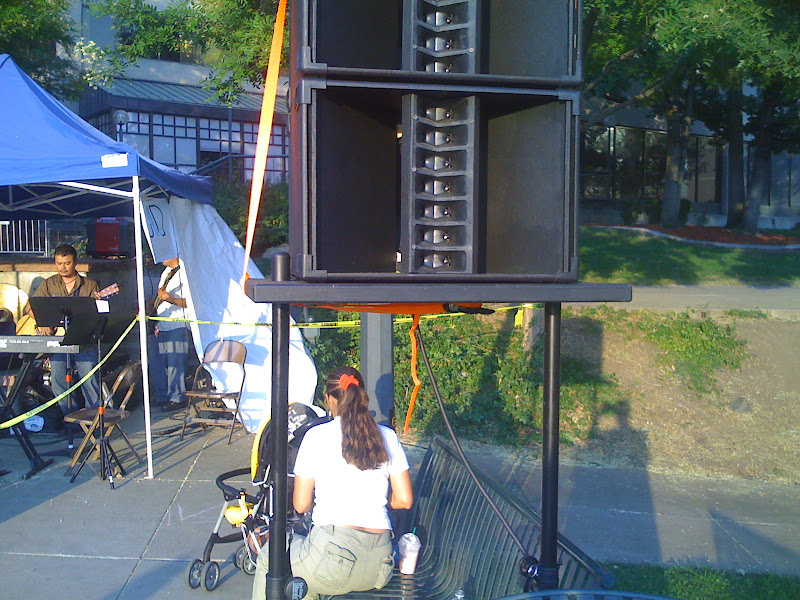

Pic of the speaker stand. It's 3/8 Arauco sandwiched over a 1x frame. The ends where the top hats come through are 1x6 and four 1x1 strips run side to side. It's lightweight and painted over with Duratex but feels like it must be molded plastic or something. The top hats run through and help position the speakers on center. 3 are stable, 4 up gets a little tippy front to back, mostly because of the stands themselves. First time I used them I put 3 up unstrapped and didn't feel nervous at all. If you built it with a triangular back you could support the platform with 3 stands and then you could easily put 4 or more on it.
Re: Durability and high pass for tweeters
Looks good! So if I'm understanding the platform right, it's supported by two speaker stands? We've got 4 stands which we rarely use, so when I build our tops that looks like the way to go! I'm assuming the platform is rectangular- how deep is it?

All correct. It's just a bit deeper than the OT12's. I think 1" of fudge room front and back. I laid it out so there was about 1/2" either side between speakers and top hats sticking through. That was the major dimensional calc I had to do.boojiewoojie wrote:Looks good! So if I'm understanding the platform right, it's supported by two speaker stands? We've got 4 stands which we rarely use, so when I build our tops that looks like the way to go! I'm assuming the platform is rectangular- how deep is it?
