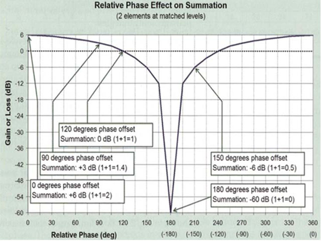

From Bob McCarthy's outstanding book "Sound System Design and Optimization"
Is this graph of harmonic wave summation:
Wave Summation and Cancellation follow this phase relationship: Relating Phase to distance:
A 100Hz wavelength has a 180 degree space of 5.65' ( 1.715M )
a 120 degree space of 3.7' (1.14M).
For a lower frequency and longer wavelength: 80Hz has a 180 degree space of 7' (2.14M) and a 120 degree space of 4.7' (1.43M).
