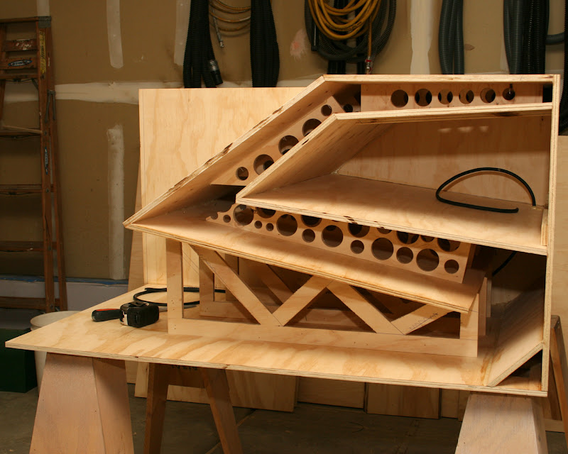

Sydney
Triangular Holes
#10 Post by Sydney »
On my T24: Cut holes on unseen braces - Switched to truss style webbing on the rest.
Rounded edges and coated w Duratex for contrast.
Sorta visible in this pic
