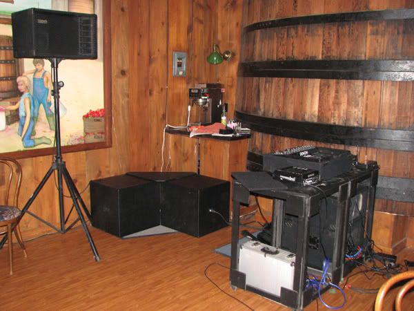

Well the first of two weddings is done and the first night went well. I set up two T18's v coupled and a pair of Omni 10.5's at the end of a 25' by 60' room at a local winery/restaurant. I didn't get a chance to RTA or set the EQ so I bypassed the EQ and set the X-over to about 70HZ and did the rest by ear.
The Omni's:
I could definitely hear the spike in the 10K range on the melded array but I just padded it down using the strip EQ on my mixer. The vocals were very clear and overall it sounded very clean. The volume at the far end of the room was still good enough for folks to hear the speeches and background music. I ran the system at about 95~100 dB all night and never really opened it up fo fear of blasting out the folks closest to the dance floor. (I hate long skinny venues...)
The T-18's:
I can't comment on the Vplate since I haven't run the T18's without it yet. (that will be a later SPL day...) I tried to corner load them as best I could but since this was a winery I was stacked next to a monster wine cask. (see photos) Even with the less than optimum loading it still had a nice presence throughout the room even at the other end. The volume certainly wasn't like at the dance floor but the lows were still in the mix. They were very tame during the beginning of the night (Back ground music and program material from the 50's through 70's. Songs like "Brown Eyed Girl" and "ABC"... ) Once I moved into the newer dance stuff that's when the T18's got nice and angry... I put on "My Humps" and I thought the coffee maker behind me was going to fall apart. The groom came in from the bar and said when the song started a number of people looked a little startled and and were looking around the room. The T18's definitely came alive on the newer songs. I had the amp limited to about 22 volts but I don't think I ever got into that range all night. The channel strips hung out in the 4~6 range all night and the amp never broke a sweat.
Overall I was really happy with the sound. (insert a big thumbs up here)The Omni's can definitely run away from the T18's and I had to back them off to even out the mix. I also noticed the transition at the X-over frequency wasn't as smooth as I would have liked, the Omni's didn't seem to pick up on the mid bass where the T18's dropped off. I'm guessing that had more to do with the lack of time available to run a quick SPL and set the X-over up a little better than anything else.
In another hour I'm off to another wedding so I'll see if I can get some more time on the EQ and X-over settings. I'll have more tomorrow....

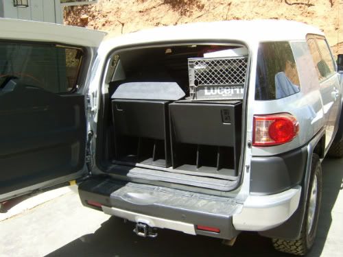

The set-up:

So does anyone else look at this picture and go Hmmmmm.

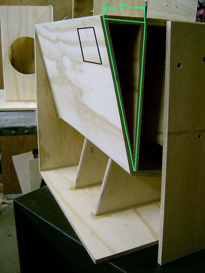

You did some minor extending right? What's the dims?

I added 1" to the width and 3" to the depth. The cabinet is now 21X19X19 so I guess it's officially a T19.67
I added the 3" to the depth so I could add the speakon connector to the front and not worry about leaks in the horn. The pic below gives you an idea of the "dead space" where the speakon and T -nut for the V plate go.

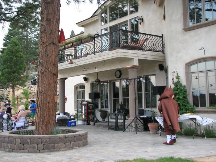

part deaux...the more I listen the more I like. I got to do an outdoor party for some friends of ours that we DJ for every year.
So I got to try out two arrangements in one night. I began the party with the system set up on the back patio. The Omni's were against the back wall of the house (about 2~3' from wall) at just above head height. The two T18's were loaded against the rear wall of the house under the balcony. I had planned to V-couple them but the space available for me to walk would have been to small so I just laid them on thier sides bottom to bottom.
I did a quick RTA from the patio and the sound was reasonably smooth with a small bump in the 8k range. I went back the to EQ and smoothed out the upper end a little and all was good.

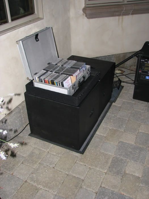

At about 10:30 the neighbor came by and asked us to turn it down so we moved inside. I brought the Omni's in along with 1 of the T18's. I loaded the Tuba against the wall (no corner available) and stacked the gear on top of it. No real surprise, the system rocked inside. In both cases I don't think I had the amp over 1/2 what it could give and it cruised all night long.

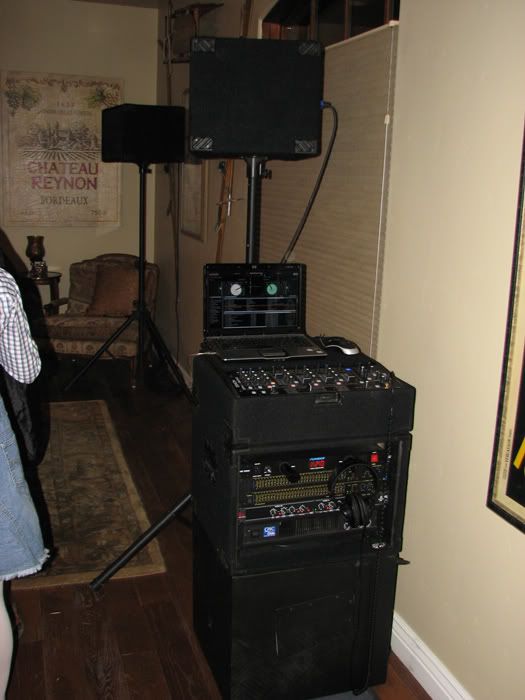

Pics....
The patio: I was set up under the balcony, you can just make out the Omnis under the balcony.
The Tubas: Did I mention how much I like having the speakon jacks on the front as well as the back? Look Ma, no wires...
After the move inside: I found another benefit to the additional 3" I added to the T18...My gear stacks on top nicely.
see the post about a 1/3 of the way down the thread...

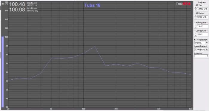

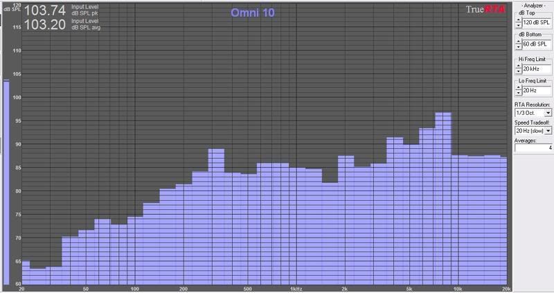

Some information from our RTA party yesterday (Kaptain John and I)
Disclaimer: the SPL readings are subjective as are the TrueRTA plots since I was using a Radio Shack Digital SPL meter as the Microphone, and the testing was done outside. (John's backyard) The AC compressor kept kicking on occassionaly and a light breeze picked up near the end of the testing.
The Omni was tested on a tripod about 4~5 feet above the grass and the RS SPL meter was also mounted to a tripod roughly a meter away. I wouldn't put any stock into the SPL readings listed on the TrueRTA screen shots since I didn't calibrate the mic to the program. We used the Binks test CD and set the pink noise track for 2.8 volts (no load) then plugged in the Omni and ran three plots. This is an average reading from the three.
The Omni 10:
I now see why I thought the bottom end was a little thin...because it is. I strayed from the plans and added a divider behind the melded array because I had some leaks. I'm guessing maybe I ate up a little too much airspace in the process and killed off some bottom end. I'm not too worried about it since I'll always be using these with the T18's anyway. (Now that I've seen the light and given up the dream of tring to have "full range" cabs 20 feet away from each other...)
I can also definitely see the spike at 8Khz I was hearing. This is also tamed with a little eq and I figure it's just a byproduct of the Melded array. I'll take the great wide dispersion of the melded array over a more even RTA plot any day.
The T18:
The SPL is off a little from what is published on the site but I do know the SPL meter was reading 103 overall. We set the output voltage to 2.8 volts using the 1K test tone on the binks CD, then ran pink noise through filtered at 33~125 Hz. I have heard that the radio Shack SPL meters are notriously bad in the lower frquencies so I can't wait to get my Behringer RTA Mic and try the plot again...

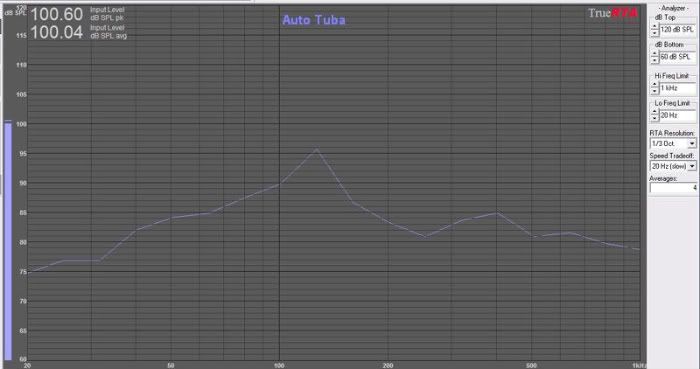

Here's my AutoTuba just for comparison. Same voltage, same pink noise. We just unplugged the T18 and swapped in the AT...

You won't get the same measurement from an O10, or any cab, on a stand versus half-space. When measuring with a noise source it will come in 6 to 12dB lower than with a swept sine wave, depending on the resolution used.
