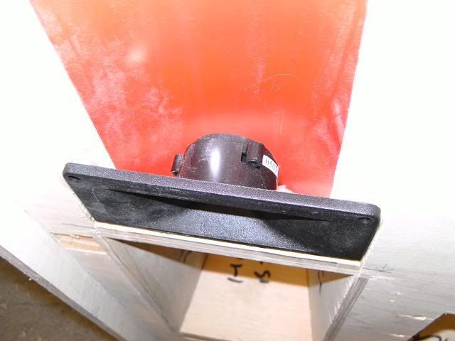

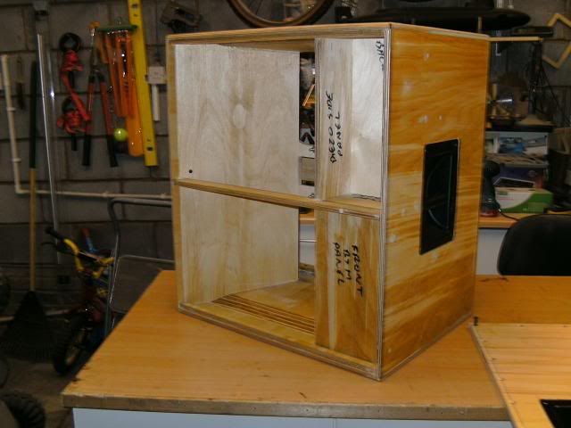

What cab is this for ?
I have done this on my last two builds:-
Omni 10 I made a simple box to seal the piezo array:-
On my Omni 15 I used a half round section of PVC to seal in the piezo array, although this is not deep enough for the melded array. I am retrofitting a melded array tonight so will have to figure something out....best laid plans and all that....
It removes all elements of doubt as long as you have the space to build one, and also keep the box size to an absolute minimum so you are not loosing to much internal cab volume.
Dave
