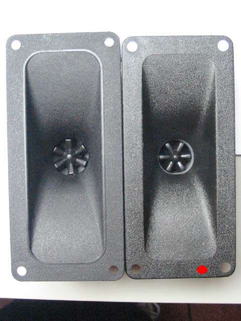

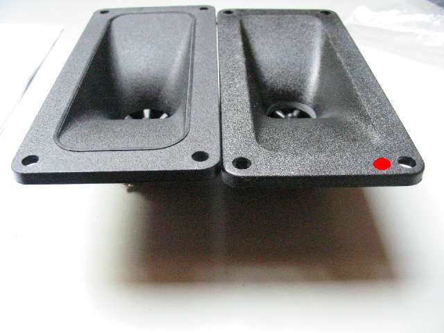

Here are some pics of the two models of piezo's that I got. Model with the red dot is good quality, the other model is rubbish (at least in the 20 pieces that I got).
The cheap model consistently has slightly sleeker looks. The one that looks a bit simpler in construction, and also shows some heat/glue in the horn, is far better. Louder, more consistent response, no faults in a batch of 20. The cheap model was perfect for practicing, but my next order will be the "expensive" model (costs 4 to 5 times as much, well worth it if you ask me).

AntonZ wrote:Here are some pics of the two models of piezo's that I got. Model with the red dot is good quality, the other model is rubbish (at least in the 20 pieces that I got).
Your results are the same as mine. Here the better ones are sold under the Goldwood label, the bad ones under the Pyle label. Oddly enough there's no appreciable price differential.
Posts: 2700
#12 Post by AntonZ »
Bill Fitzmaurice wrote:Your results are the same as mine. Here the better ones are sold under the Goldwood label, the bad ones under the Pyle label. Oddly enough there's no appreciable price differential.
Odd indeed. Cheap model: some 0.60EUR each, the good model is about 3 EUR. No brand as far as I'm aware, but model nr MPT-016.

The piezo with the mould line around the top is the same as the WLE piezo's that I got in the UK....crap, crap crap....build quality was rubbish, sound was inferior...nothing in its favour other than it was cheaper....but then piezo's are so cheap anyway even the expensive ones are still cheap... :D
