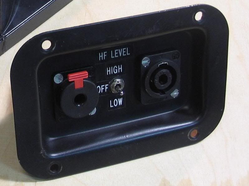

I'm thinking of doing something similar for my DR250's. I used a P.E. jack plate for my O10, but, like you, I don't want the switches sticking out this time, and I was afraid I'd ruin a perfectly good jack plate if I started cutting holes in it for switches.
David,
This is the jack plate I prepared for the 10.5 I built.
I used a short stem mini toggle that didn't stick out over the height of the dish.
fender3x,
As others have mentioned you did a great job, especially as a first timer.
Only thing I would change are the eight non-black screws holding the Jack plate... :wink:

N.Webber wrote:This is the jack plate I prepared for the 10.5 I built.
Nice job on the jack plate! What did you use to label the switch?
Dave

N.Webber
Posts: 244
Location: ISRAEL
#15 Post by N.Webber »
Brother's P-Touch.
