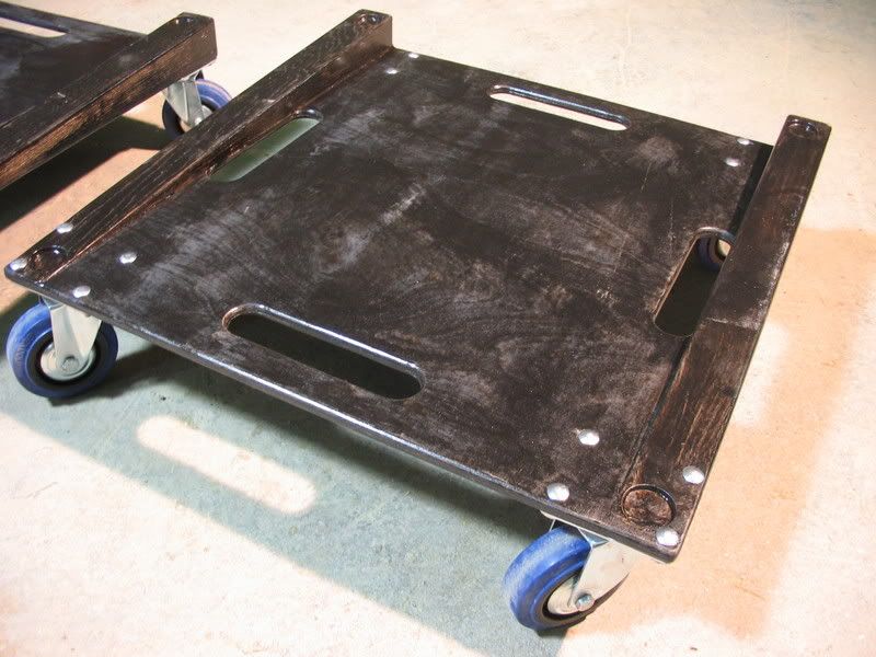

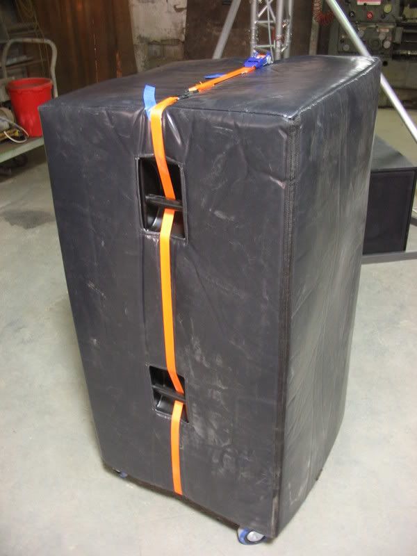

This is what I did with my 290s.
Each cab has four plastic feet (at the bottom…) and four mating recesses at the top.
Caster board has angled blocks to match the cab's bottom slope, also with same recesses.
Here:
Each caster board caries two DR290s.
The lower cab sits on the caster board and the second one is rotated 180 deg. and fits on top of the first.
The padded cover is then slipped over and the whole pack is tied with one ratchet strap.
Works great.
Like this:

Les Webb
Posts: 796
Joined: Mon May 08, 2006 10:12 am
#13 Post by Les Webb »
Now that is SCHWEET!!!!
Really nice concept and covers.

#14 Post by Art Coates »
N.Webber wrote:...The padded cover is then slipped over and the whole pack is tied with one ratchet strap...
Definitely a slick setup. I use feet and plastic corners on DR, feet/wheels on Tuba. I'll definitely consider the cover/dolly option for any additional cabs!
