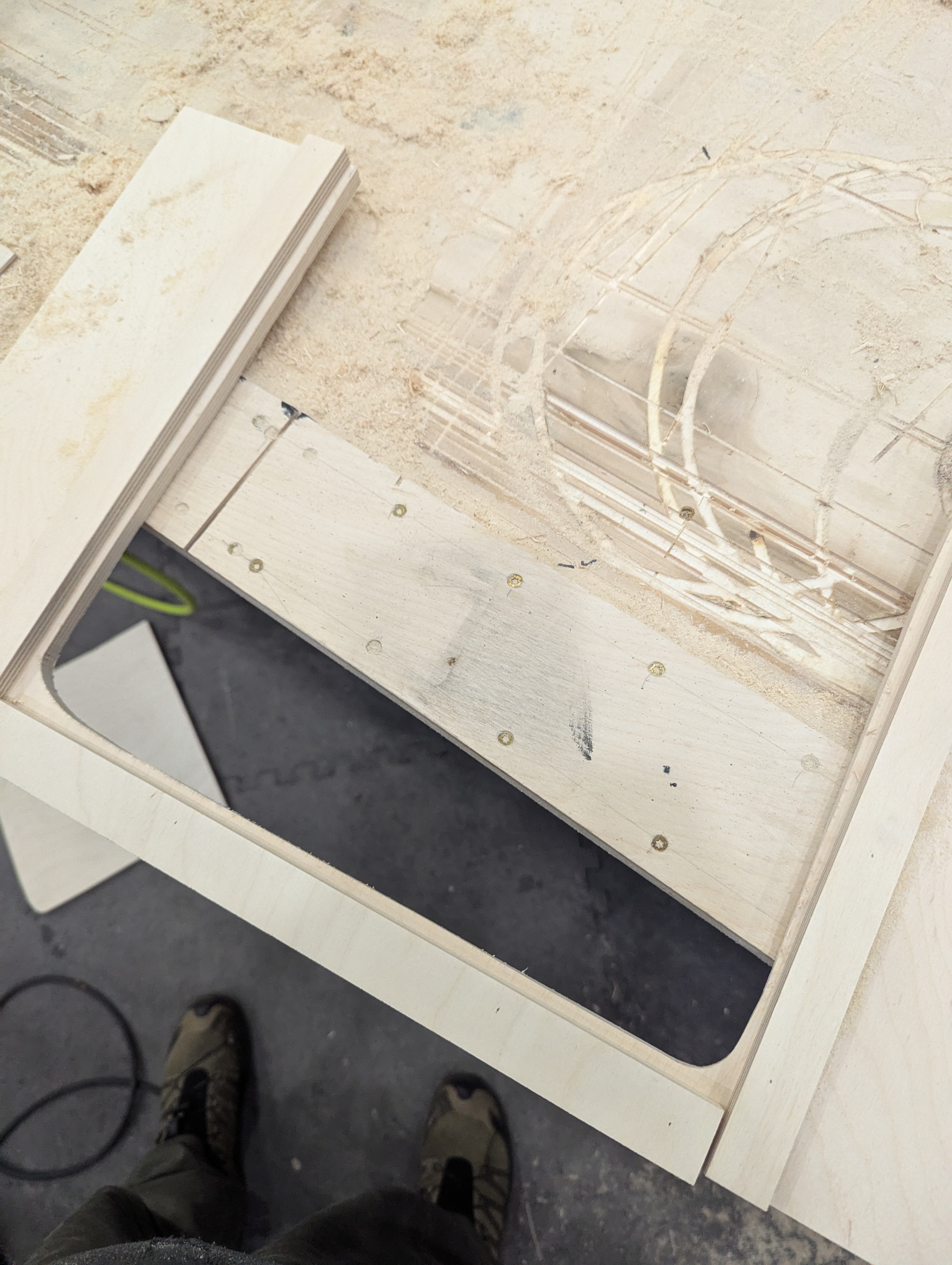

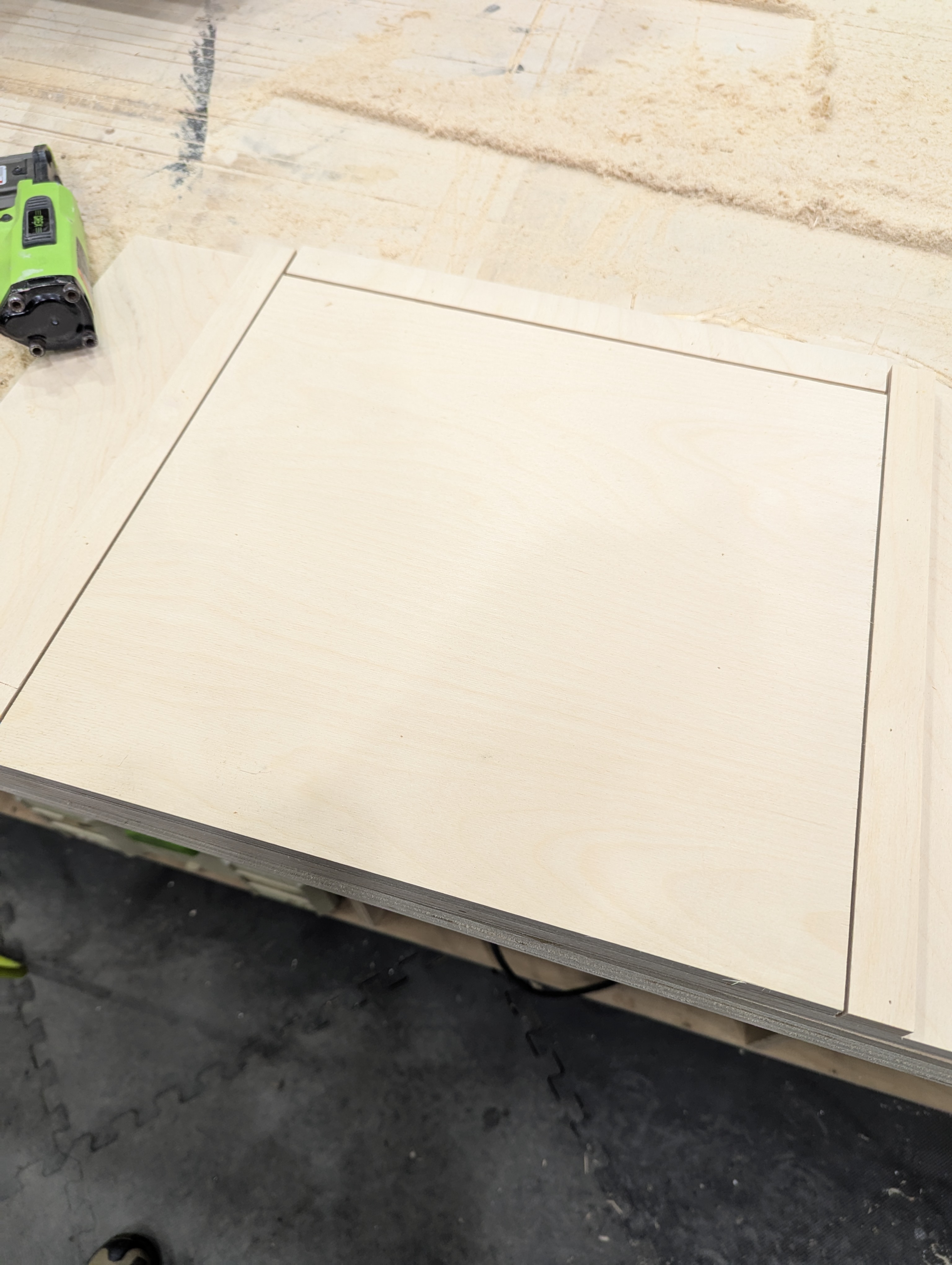

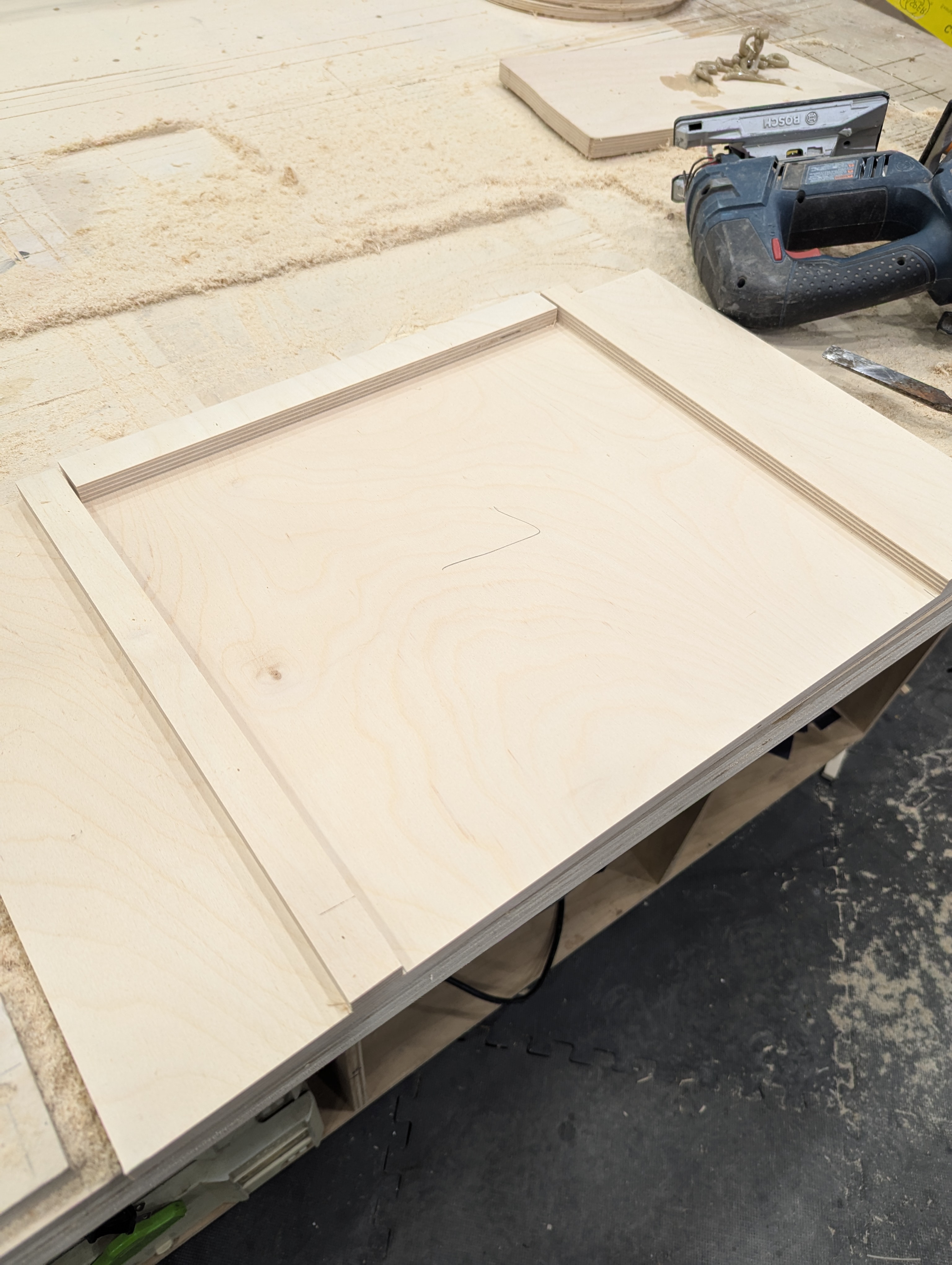

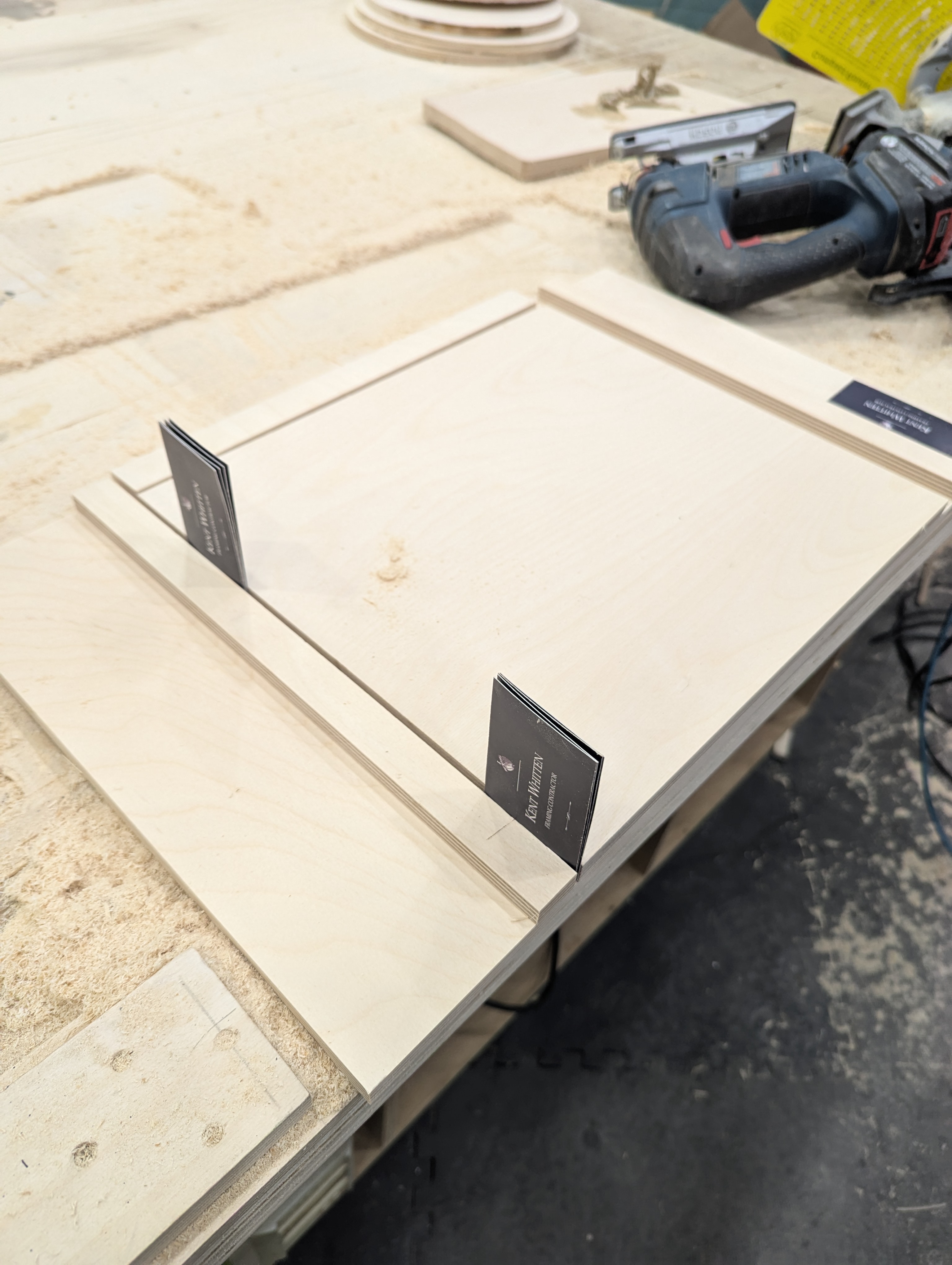

I reverse my 5 and 7 panels from the pdf file. I like to get that front access panel just right. I have Rhino3d CAD and re-did all of the measurements to get accurate measurement of that front panel. I seem to have it dialed in, this is the third one I have done like this and it seems to have worked.
I'm going to try to explain my procedure for my access panel, though some of you probably already do this. It's just one of those nitpicky things I do, I like my reveals tight and even. I start off with the actual door access panel to size and place it centered, or wherever (in tubas case), then I add some scraps to the sides with a few business cards for gapping. You can use playing cards, this is just what I had on hand. This gives me my gapping I want to see around the door, so adjust your amount of cards for such.
Remove the cards and panel and rough cut out to size with a jigsaw. Lastly, I bring it over to the flush cut bit on my router table and flush it out. Once done, I have some rounded inside corners, I personally like them, so I leave those and blunt the edges of the door to match. I have a BOSS for that.

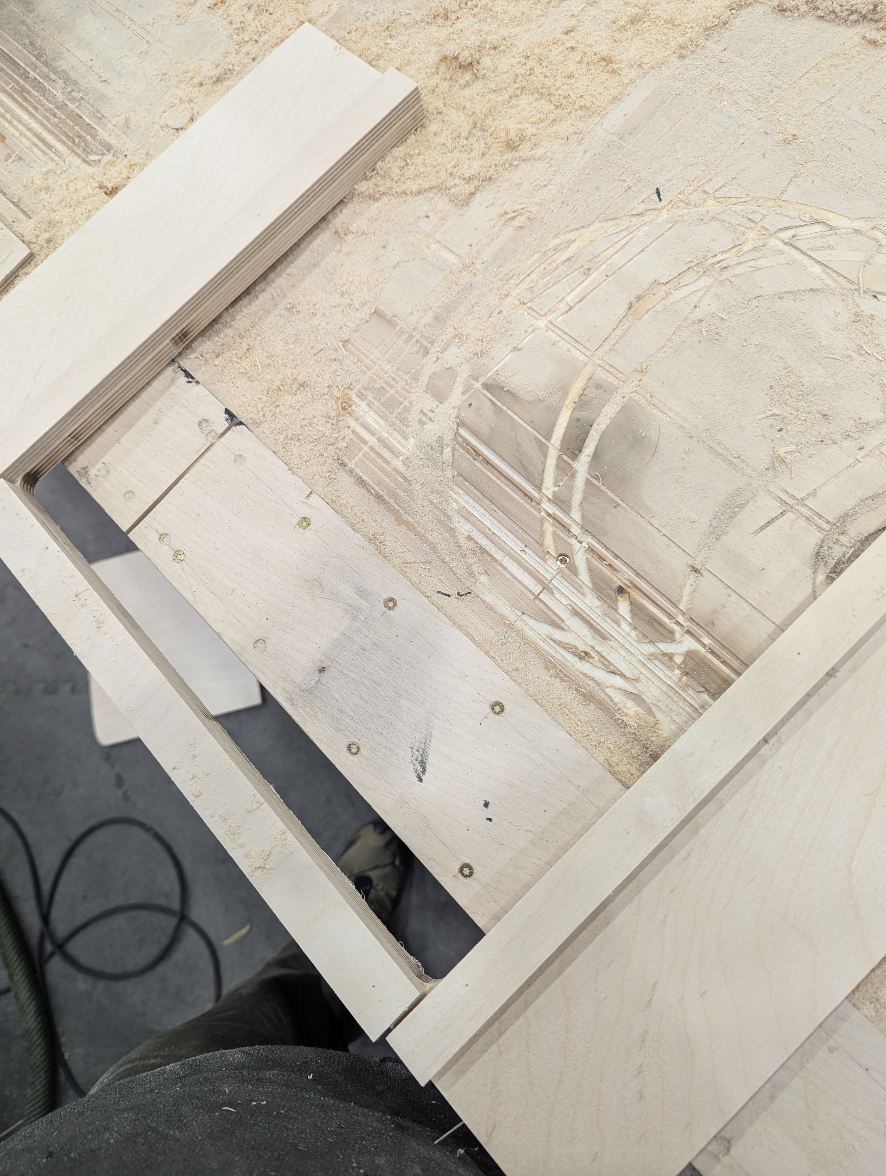

I almost always will miter fold pieces like this. I'm assuming some of you good builders here will do the same. I make sure that angle is spot on. Otherwise, it's junk

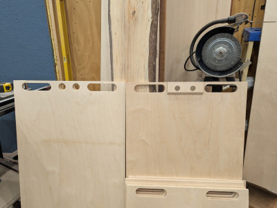

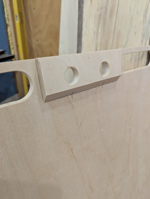

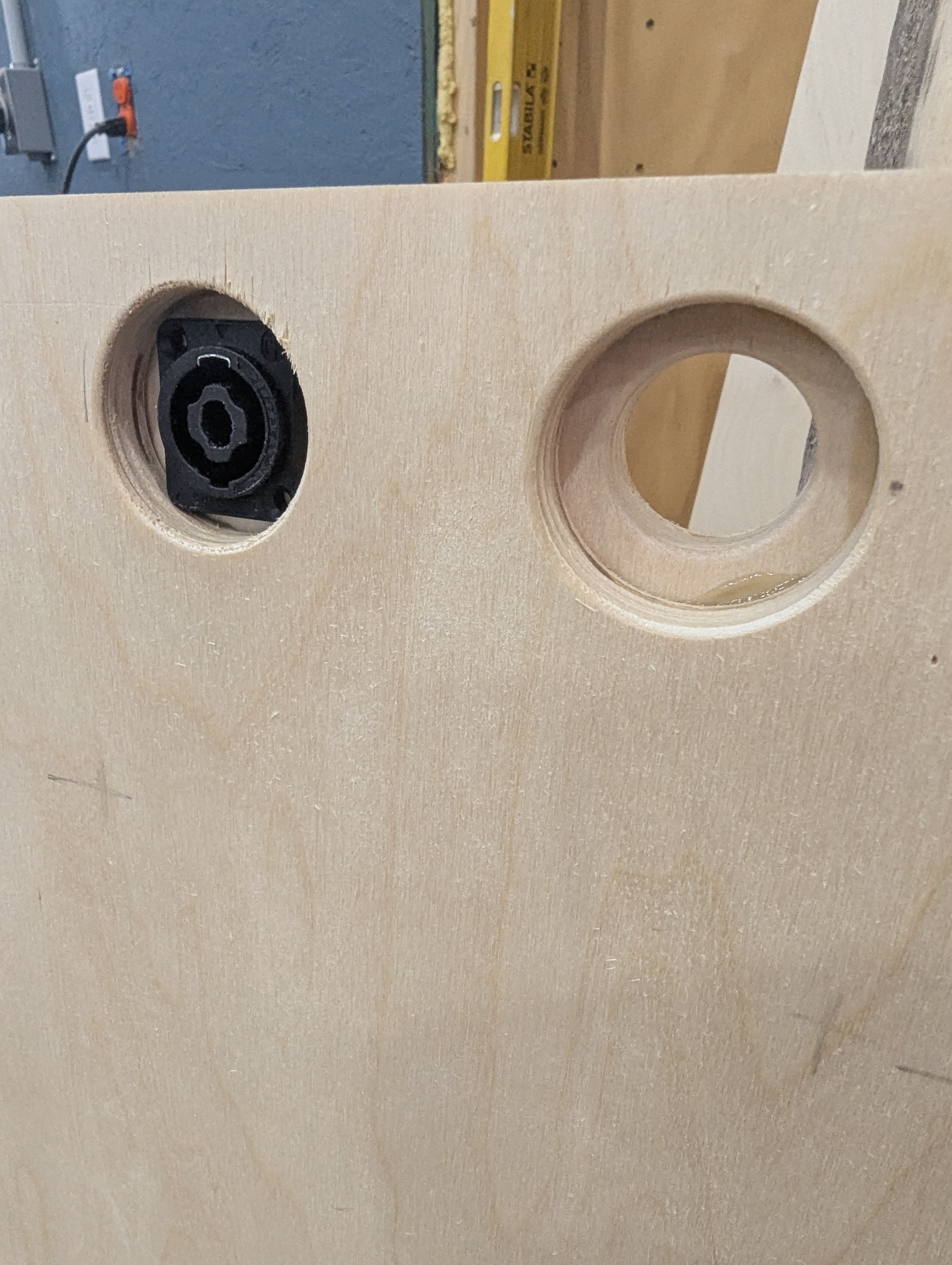

While I was waiting for the miter fold glue to cure up, I decided to tackle the handles on the top, bottom, and back. 16 handholds total to cut. I made a jig.
After the handholds, one of the most important steps IMO is recessing that speakon connector. Hopefully the pictures will explain it. The speakons will be on the top of the cab on the back panel. Plans showed it on the bottom, and I just didn't want to see a wire hanging there in the back. I made it fit
