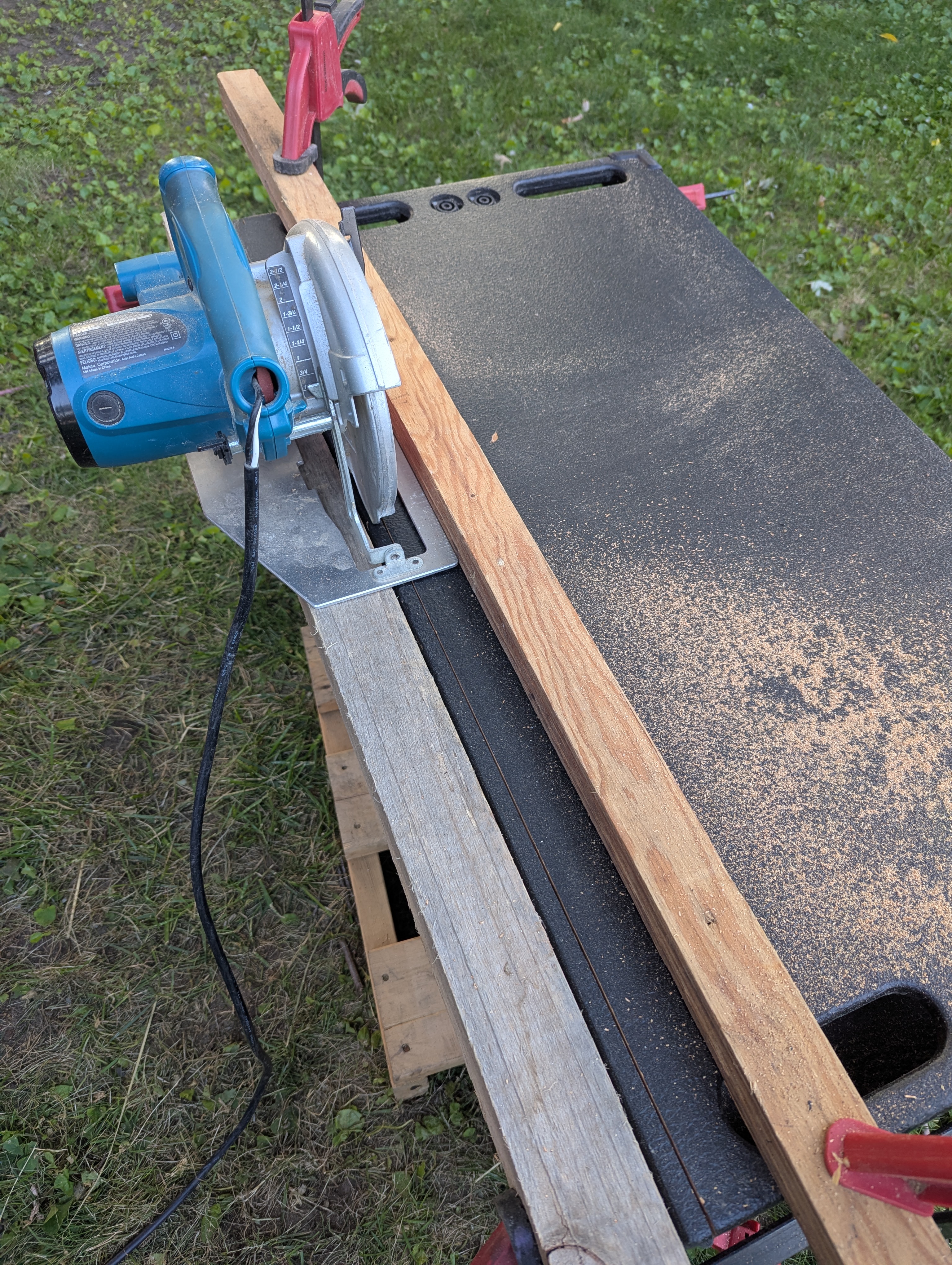

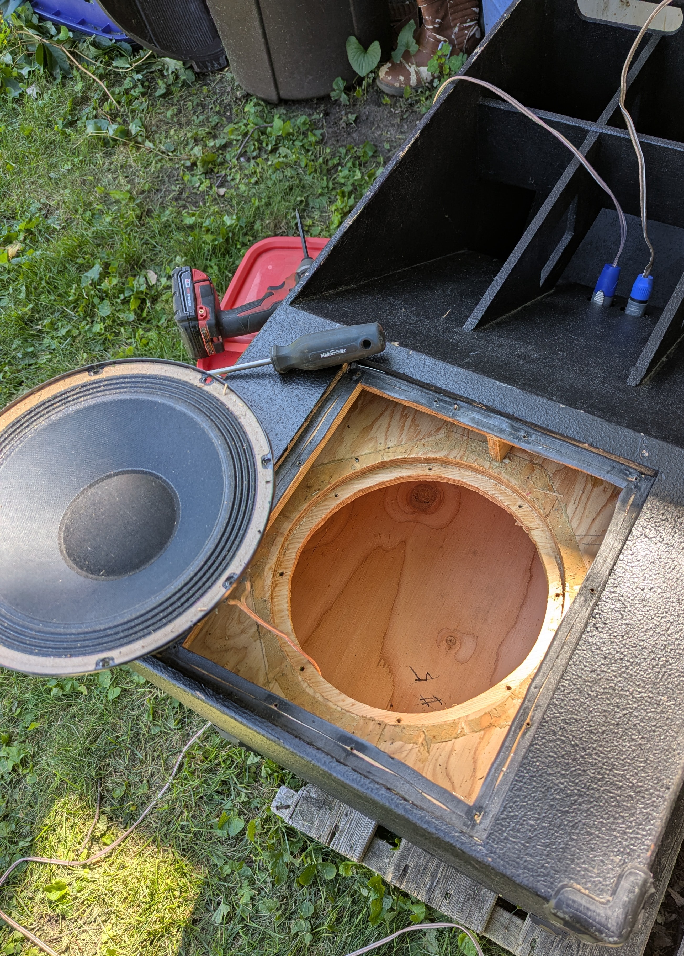

The next sub had a nasty rattle at 40 hz with 12v applied, or 50hz with 18v. I could get it to rattle if I wrapped #5 panel behind the driver so, I figured I must have a loose brace or two. Multiple holes were drilled and eventually I found the braces. I drove 2" screws to lock in the braces, installed the driver, ran the test, and.... it's still there. :wall: Now what!? Well, I thought of a member from a long time ago... Harley Dear. So, out came my hand saw

Then, it was time to cut the side panel free.

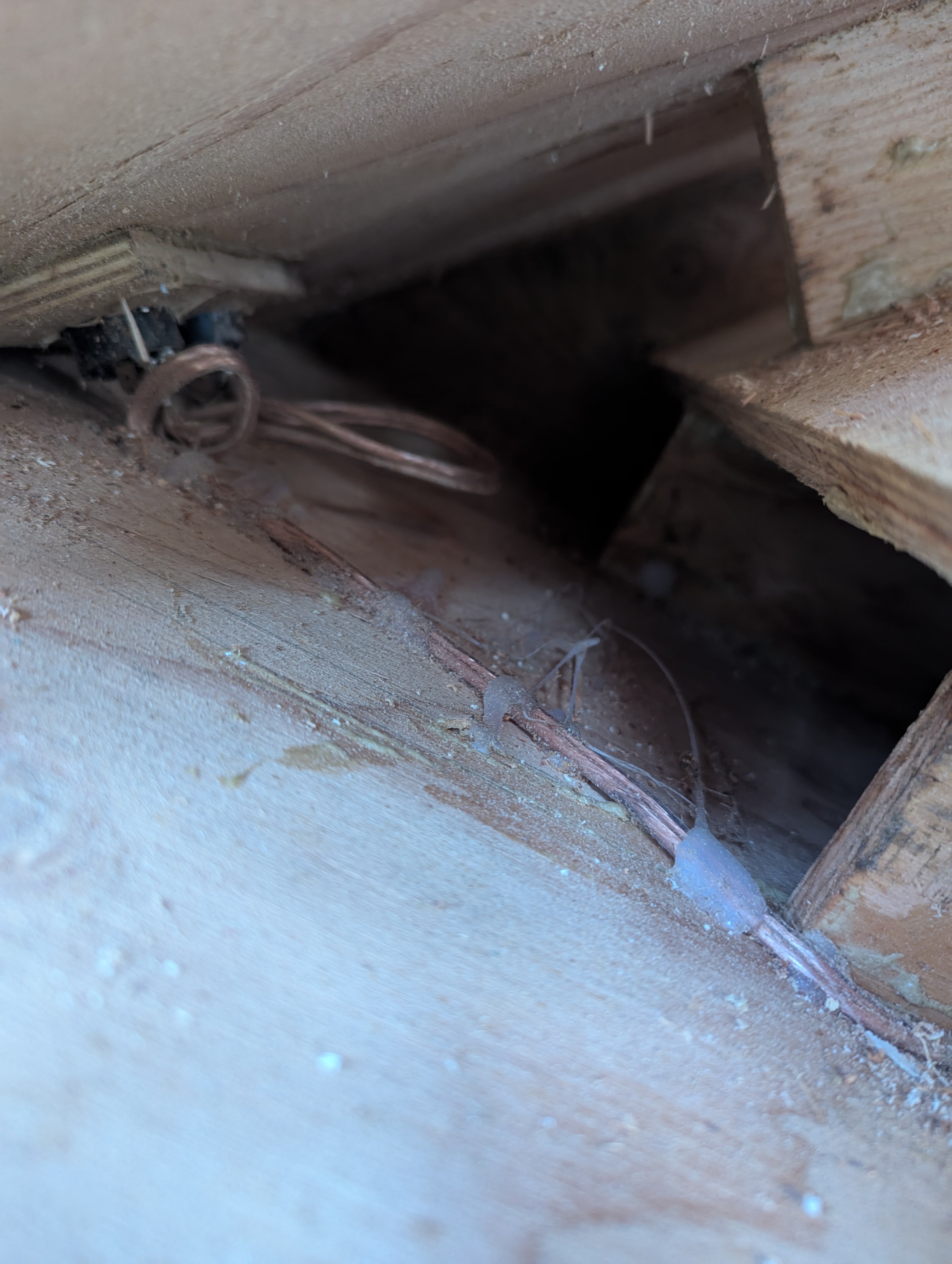

Everything seemed fine except for this jumper, so I glue in a small piece of foam underneath.

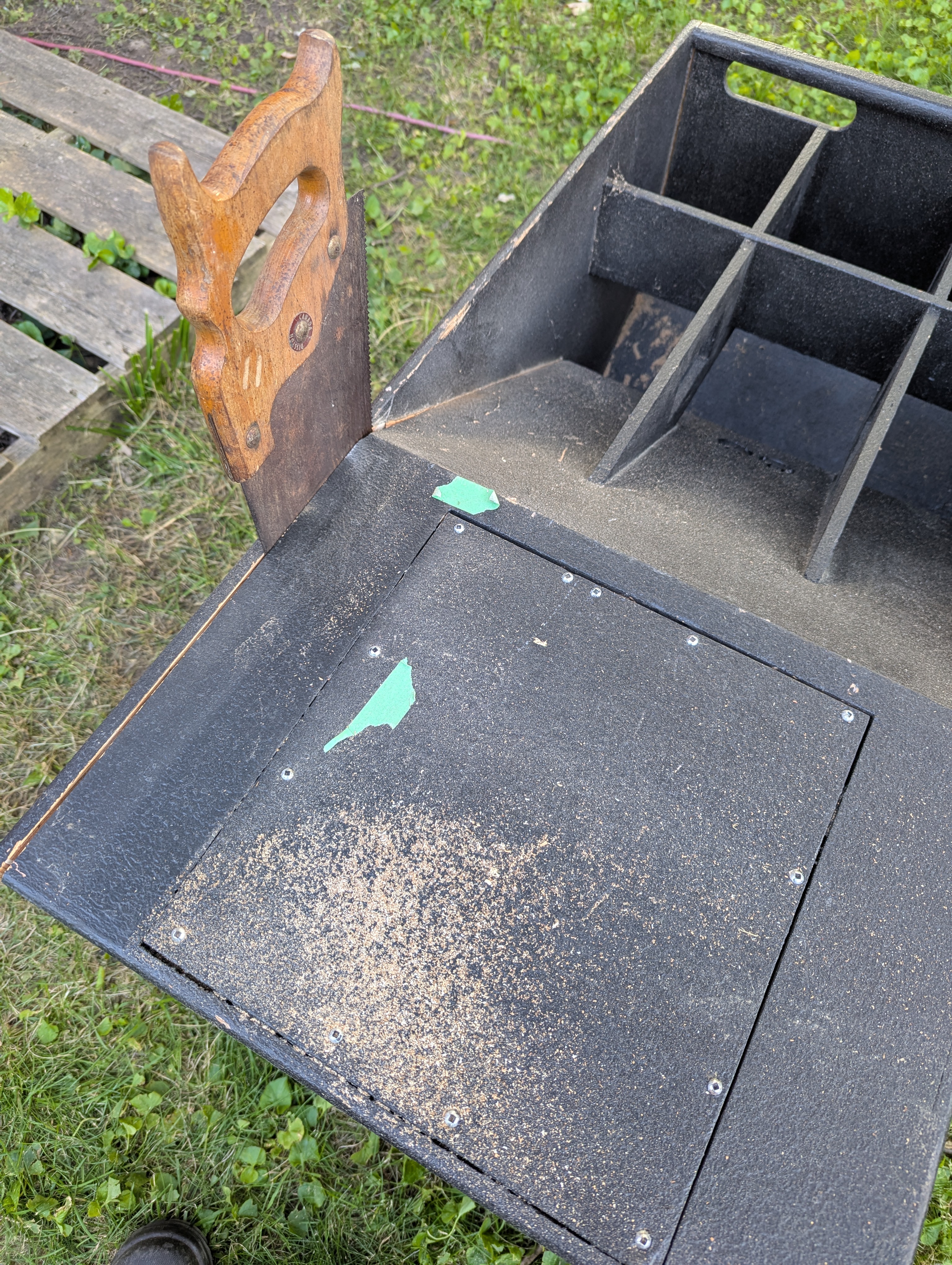

That was not the answer! I found some gaps in the small braces so I applied adhesive on any brace that I could find, and the retested. It doesn't rattle until I hit 27v. I am happy with that. I had it going at 50hz on 27v and my wife about 50ft away, in the house, and she said it was too much and hurting her ears (she IS sensitive that way).
