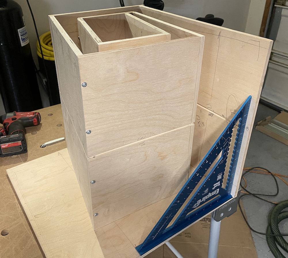

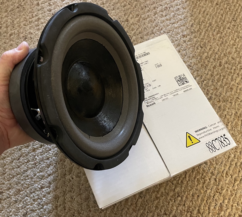

We took measurements, made a mock up and determined a classic T18 would be the perfect weapon for this CUV. That meant ordering the latest iteration of the MCM 55-2421 from Newark and commencing with the sawdust.

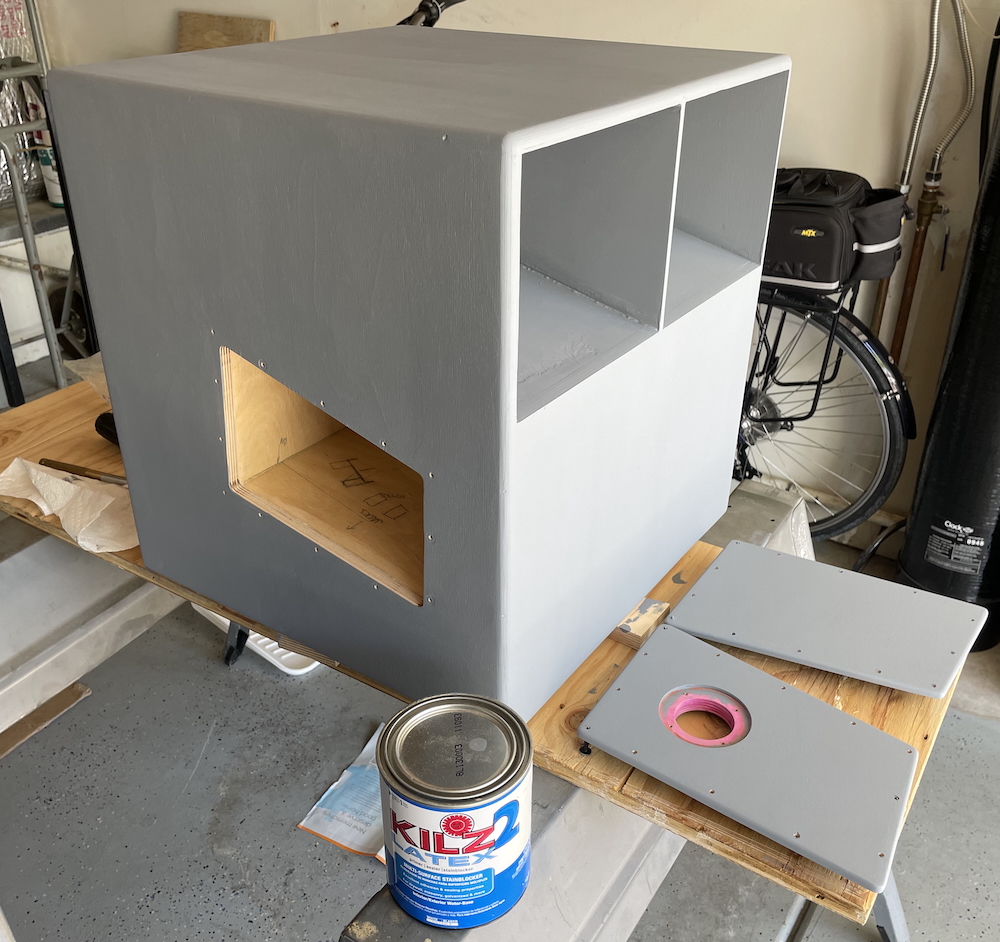

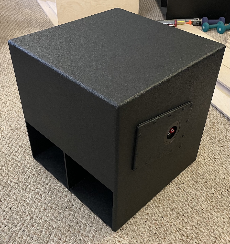

I had a can of WetLook left over from nearly a decade ago. I swore if I ever used the stuff again, I'd use a Preval sprayer (I've no cup gun, nor large compressor) instead of brushing this stuff on. But an immediately failed attempt to send this goo through these hopeless contraptions had me schlepping it on with a foam brush, once again. Looks like hell, but keeps the untreated cone from succumbing to mold and moisture. Note: Preval sprayers require very thin paints to function at all...a simple coat of clear poly would work better in hindsight
