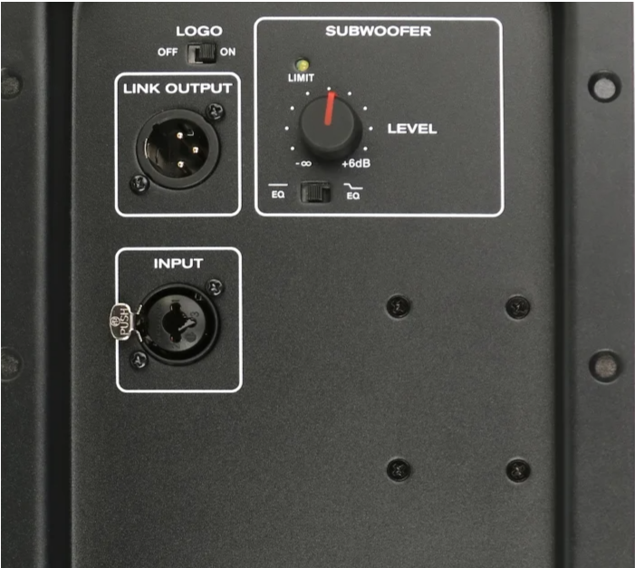

In looking at photos of that amplifier module, there's seems to be a couple different renditions. Does yours look like this and if so, is the switch under the knob switched left or right?
Something doesn't seem right. What are you using as a test signal? Source to amplifier output, what's in your signal chain?
Re: EV ELX118P power module.
Hi Seth
Yes that is the layout of the module I have. I have the switch set flat and the level set to full +6. I have played around and the only thing that seems to affect the output is the eq section set a very broad q centered around 70 and do a very intense cut at that freq.
Just thinking out loud here, but if the amp module has a corrective DSP EQ curve in it already, it could (should) be that there's a considerable boost on the bottom end... even with the boost switch to the left. You can test this by using various test frequencies and noting output voltage changes (write them down). I'd personally test every 10Hz from 30 to 150Hz just to get an idea what the built in tune is. It doesn't have to be on the limiter to test this, any level setting is fine as long as you don't change it between test tones.
If this test indicates a large boost on the bottom (which I strongly suspect it will) it may be your best bet to turn the level input on the amp far left (assuming it's unity and not full off) and disabling it somehow... maybe pull the knob, saw the post off with a Dremel cutoff wheel and either put a slot in it for screwdriver adjustment that way or a dab of superglue to disable it altogether.
Anyway, again... just thinking out loud. Maybe prime some thought amongst the group. Might be some better ideas out there.
Could hot glue the knob in a better setting, could be undone easily in the future if my plans change.
