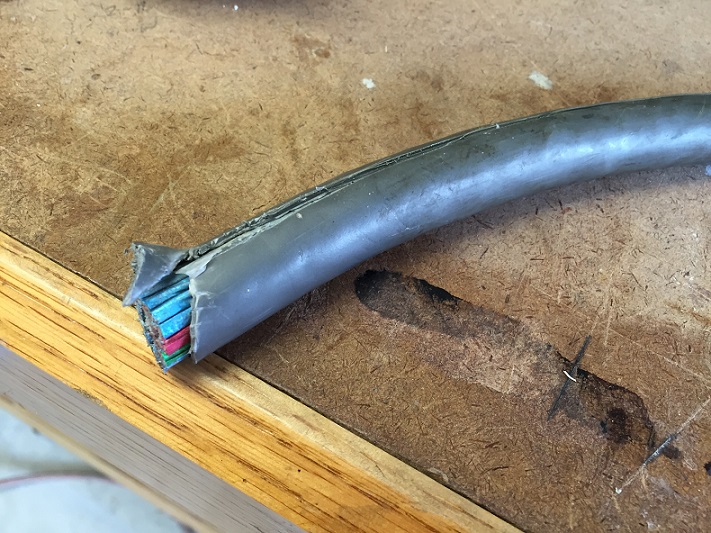

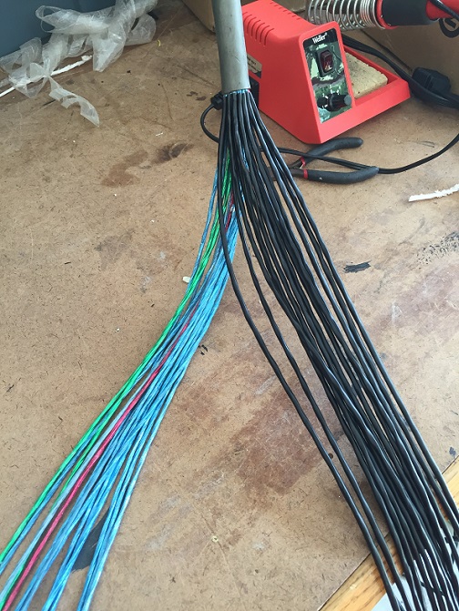

Also, there's a good chance that the individual wires inside won't be encased in a jacket. Often, snakes just have the foil wrap around the wires for each channel.
Why not just keep the snake the way it is and just use the number of pairs that you need?
Bottom line, really hard to give you a good answer until you actually get your hands on it see what's underneath.

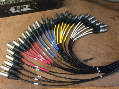

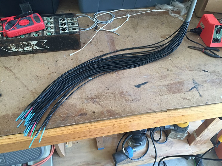

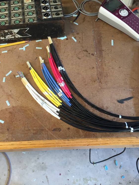

But, for you viewing pleasure.....here's the 30 plus year old snake that I brought back from the dead. All new Neutrik connectors. It was an old 24x4 snake. But, I built it where it could convert to a 22x6 if needed....just use the last returns instead of 23-24.
It's been a great snake. Never caused me a minute of down time or failure.....or course, once I built it, I put it in a tub and it hasn't moved from my garage since. Anyone want to buy a snake?
