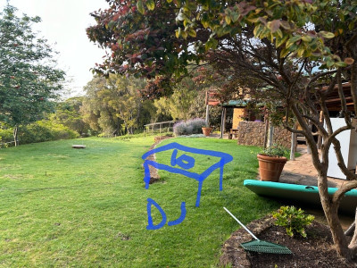

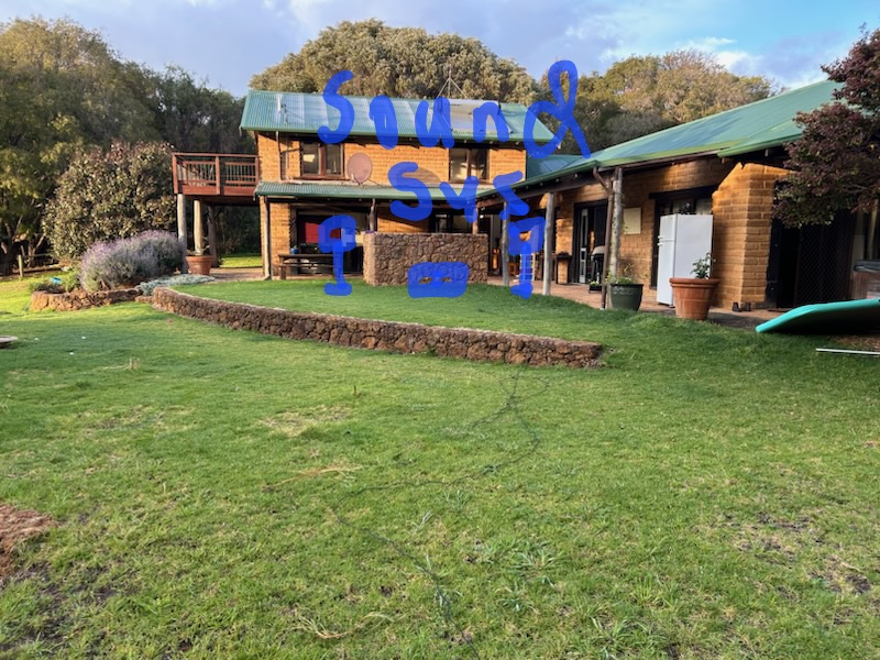

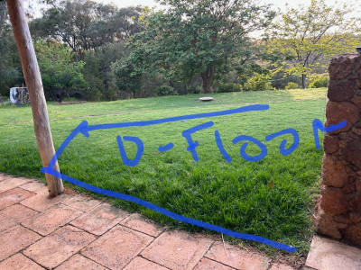

I am doing a small 2xT30 / 2xOT12 setup in a mates backyard on a rural property this weekend. Examining the low quality pictures below you will see my proposed setup idea.
In the interest of maximising SPL I'll be Vplating the subs, and I'd like to utilise the small stone wall structure seen in the pics, by pointing the subs toward it.
Questions:
1) Is that stone wall (being about the thickness of a double brick wall) substantial enough to create useful boundary reinforcement? (My guess is: probably not).
2) If so, would reflections from the house pose an issue? (My guess is: not enough to notice).
3) If not, would it be OK to setup the subs in front of it firing outwards? (My guess is: probably).
Questions:

To provide full boundary reinforcement a wall must be a wavelength wide and tall. At 100 Hz that's 11 feet, at 50 Hz that's 22 feet. You'll get some assistance from that wall, but not a lot. Most of what you get will be from the house.

The main concern is keeping the sub mouths less than 1/4 wavelength from the house. viewtopic.php?t=398

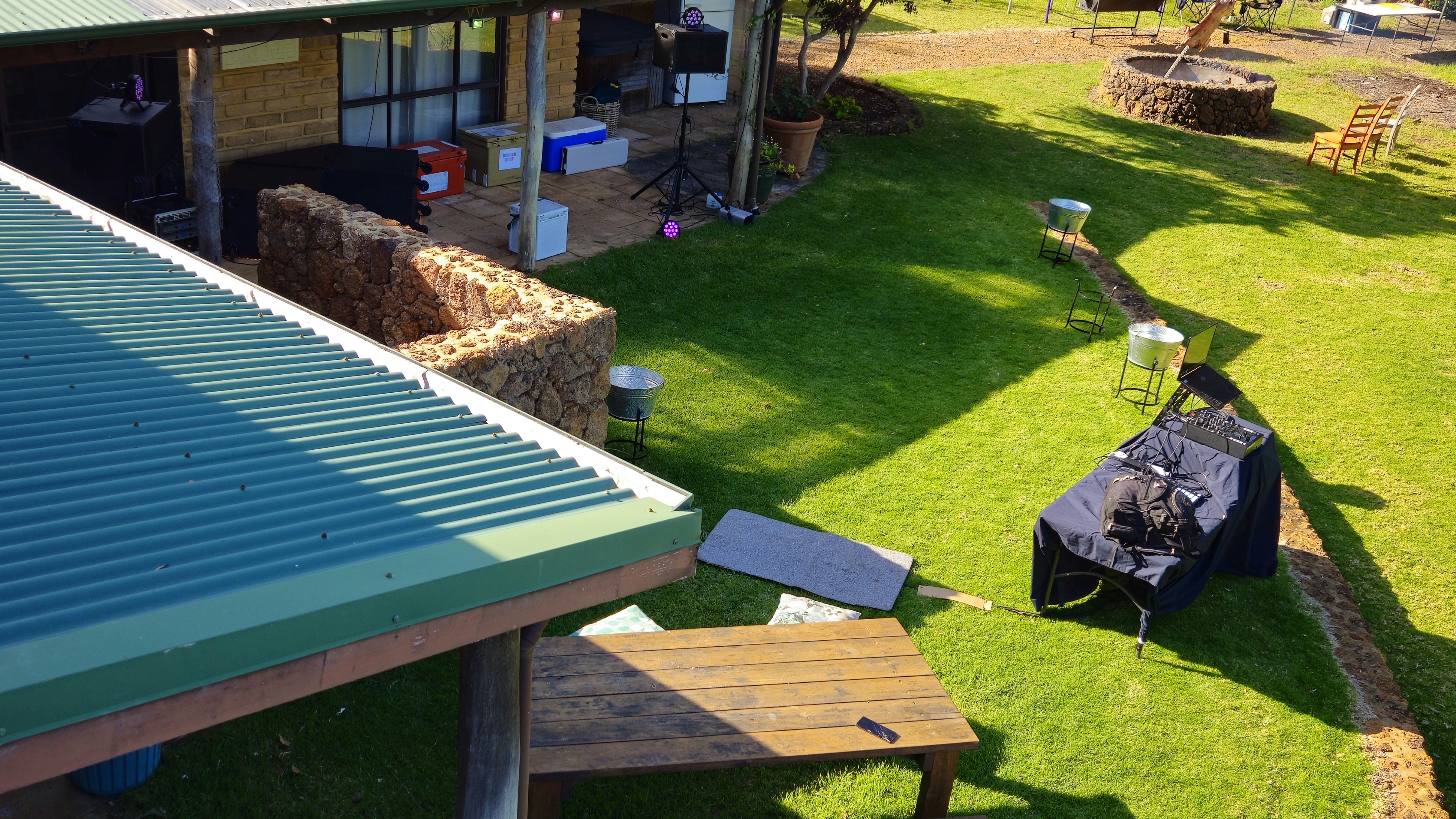

Just a quick review on this. I ended up loading the subs against the house as planned and it worked out perfectly. Plenty of headroom with the pair of V plated T30s. Didn't get many photos of the setup but can see it below.
