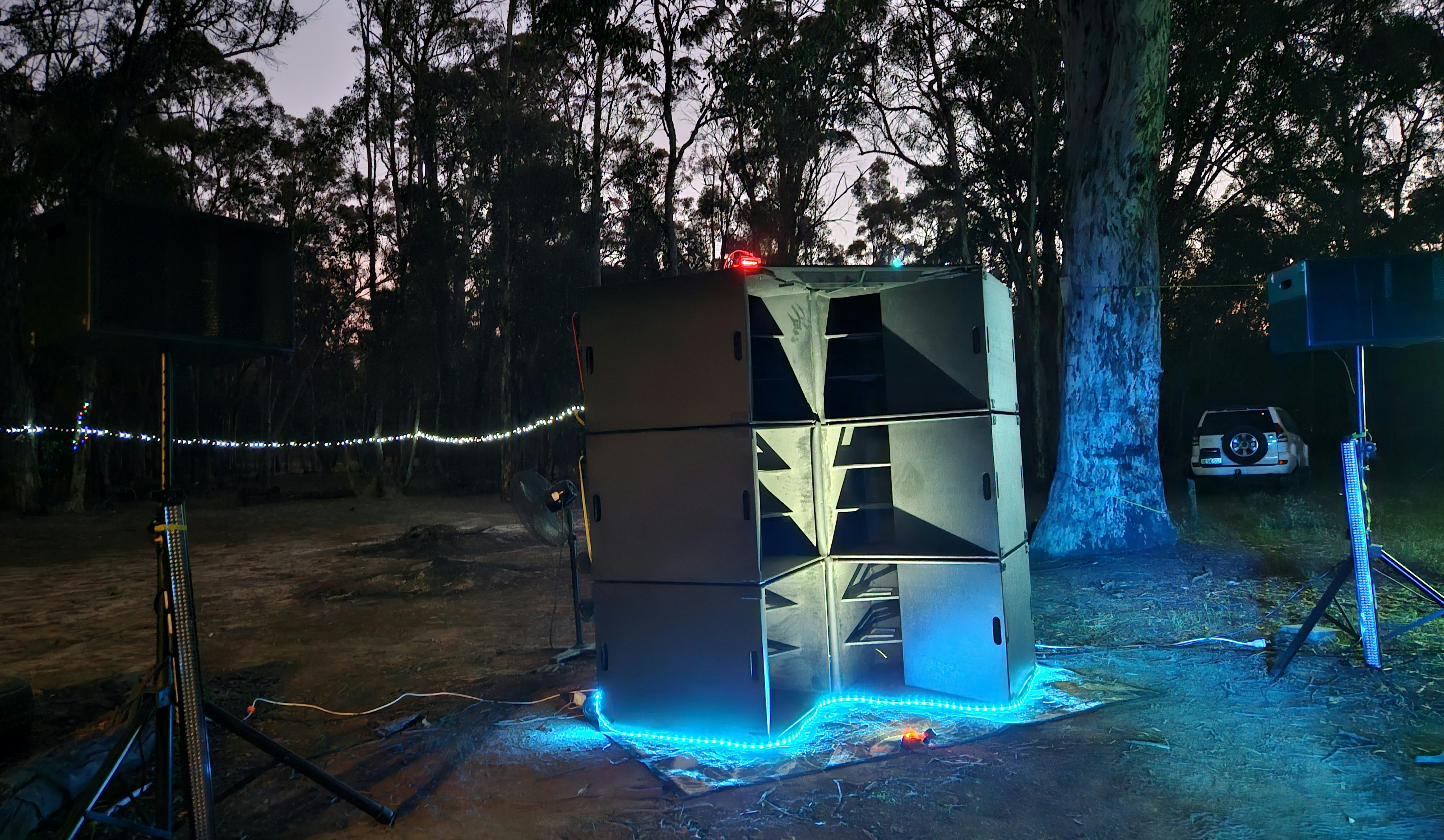

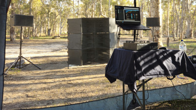

Just an old rig from 9 years ago still going strong! Had these out last weekend and thought I'd share a couple pics I took. 6 T30s is a perfect match for 2 OT12s, although I should really build another pair of tops for more even coverage (not spl).
We ran the whole system for 2 days on batteries and solar. No fossil fuel generators. Just a BYD Atto 3, 2 bluetti batteries (3kw and 2kw), and 9x 250w panels for charging during the day.

That's awesome. I love these types of reports and posts!
Textbook deployment too! Well done Dan!

Thanks Seth, yeah I'm impressed with how these subs just keep doing their thing! We do heavy electronic music with relentless and deep bass lines and they take the punishment! Haven't lost a single driver to date, and we usually sneak the high pass to 28hz when we have all 6 tethered.. just gotta keep a keen ear out for clip (yes, you can hear it pretty distinctly).
