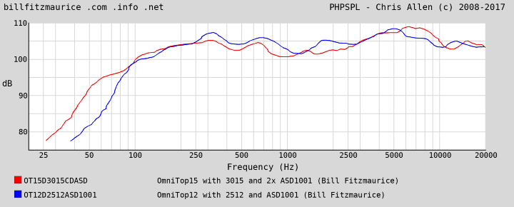

Does anyone have knowledge or access to a SPL chart for an OT15 with the KL3015 installed in it? I can’t find one, and trying to make a decision between the OT12 with the 3012HO and the OT15 with the 3015, looking for a nice solid 100hz XO to these with as much sensitivity at 100-200hz as possible to maximize the overall +/-3db output sensitivity (1w/1m). The additional size of the 15 vs 12 has no impact for my intended use, however smaller is always better for overall output per given vertical space available.

Not sure what you are using it for, but the OT12 can do everything you need above 100hz.
For what it's worth, 100-200hz is the place I most frequently have to cut on inside venues to correct for the room.

Gents thank you. Seth thanks for the curves and Bruce I didn’t account for room dynamics and gains, these will be in and outdoor use.
The 12s it is. Timeless and Priceless. They really are.
