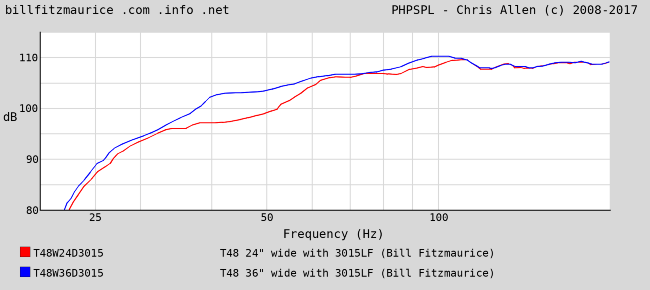

I had acquired some 24" wide T-48s with 3015LFs in them. If 36" wide versions give such smoother and louder response, why wouldn't adding a mouth flare to a 24" wide help? I'd much rather spend a couple days and $100 than weeks and $1,000.

That's what V coupling does, without the need for adding anything other than the plate.

Going back to what you're talking about and adding to the thought soup; as it occurs to me, adding any sort of extension or flare would only effect frequencies that are lower than the cabs current operational bandwidth. To make up for the 30-60Hz difference in response between the 24" and 36" cab, I think any changes to mouth/throat area would have to occur at the point in the horn path which corresponds to those frequencies... or roughly the last 4½ feet or so of the horn path... Which makes me wonder if one could simply swiss cheese the last four and a half feet of of horn path of one of the cab sides (with a hole saw, jig saw, or whatever) and box in an additional foot or so to expand the cab width in that portion of the path... I wonder if that would make up the difference, or any difference at all? Obviously, it's not a practical idea or suggestion. But, just the thought process is valuable in my opinion and I'm glad you brought it up. :thumbsup:

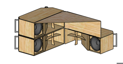

Option A add a panel where your 4th cab would be in the stack and enjoy.

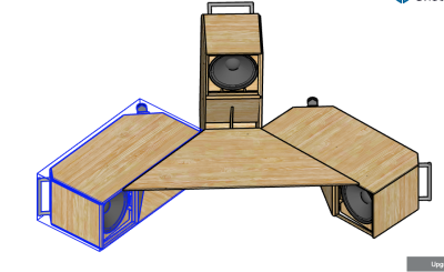

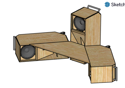

Option B is more fun, I'm naming this setup "The Scorpion"
Unfortunately, this setup is probably not recommended as the center cab is half in, half out of the vplate.

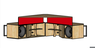

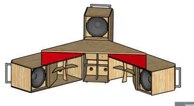

If I understood Seth correctly, Option B-Plus incorporates a little of what he was talking about with extending the width (height) of the 2 cabs in the V-Plate. shown here in red is a 10" (tall) panel added to the 2 lower t48s.
There may be some merit to this idea. unknown.
