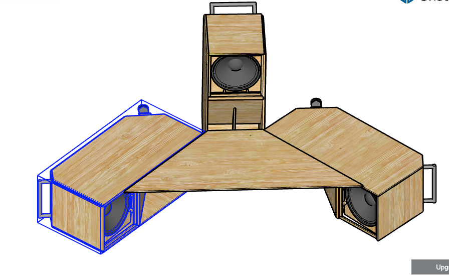

Ok, before going crazy man, could a "U" plate be built for three cabs, as in 2 outer cabs at 90 or 45 degrees to the central one? You could build your horn into that, so you don't need to modify the existing cabs

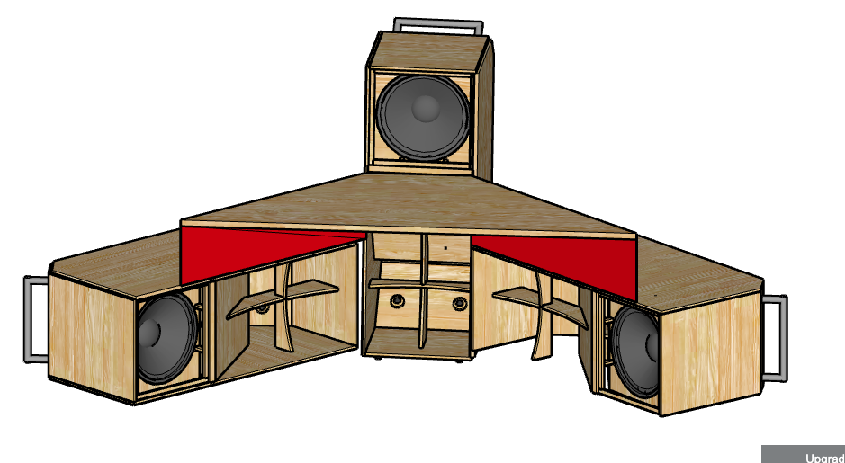

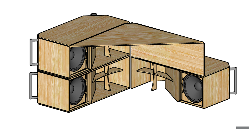

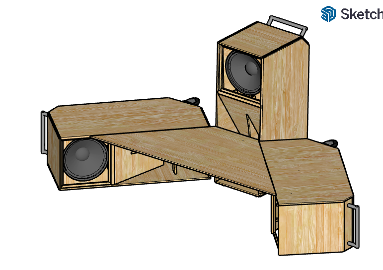

OK, so you've all got me thinking today, and I made a few Sketchup modifications for us visual learners out here.
as usual you gotta trust that Bill is right, and the correct answer is to V-Plate the T48s for better low end sensitivity.
What does that mean if you only have 3 cabs?
Option A add a panel where your 4th cab would be in the stack and enjoy. Option B is more fun, I'm naming this setup "The Scorpion"
Unfortunately, this setup is probably not recommended as the center cab is half in, half out of the vplate. If I understood Seth correctly, Option B-Plus incorporates a little of what he was talking about with extending the width (height) of the 2 cabs in the V-Plate. shown here in red is a 10" (tall) panel added to the 2 lower t48s.
There may be some merit to this idea. unknown. Back to the original idea of extending the mouth area of a pre built cab...

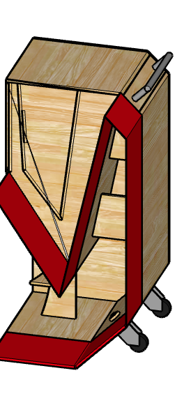

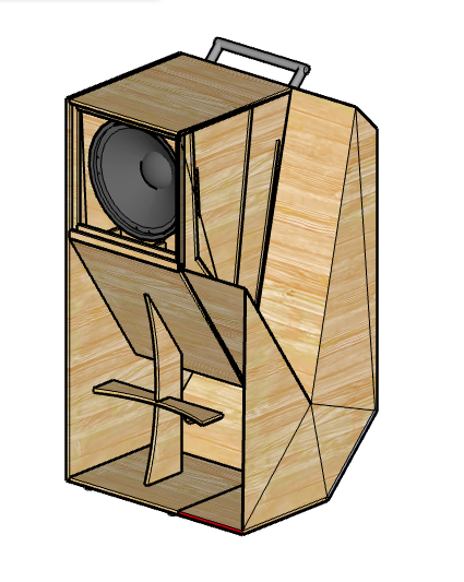

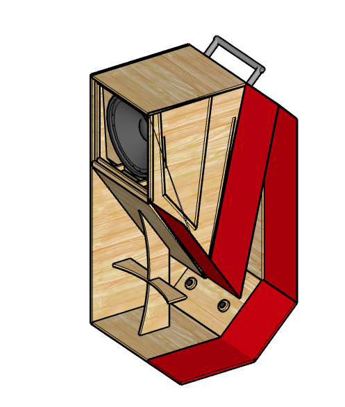

I envisioned something like this, where you could cut away part of one side (or both I guess) to reveal the last half of the horn path and extend panels 5 through 10 a few inches to achieve your desired mouth area.
I fear you would be left with a very interesting looking cab, but I am curious to learn if this could be a viable alternative to rebuilding a compleet wider t48.
Re: retrofitting larger mouth
Kevin! I love that you ran with it! You nailed the rendition of the picture i had in my mind about adding width to the last 4½' of horn path. Amazing!
As far as combining and V-Plating an odd number of cabs, I think the cleanest way would be to place the cabs side by side upright on the ground, tilt the lot of them forward 45°, and put half V-Plates at each end.
More to say about your post... tomorrow.
