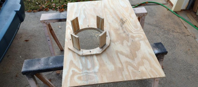

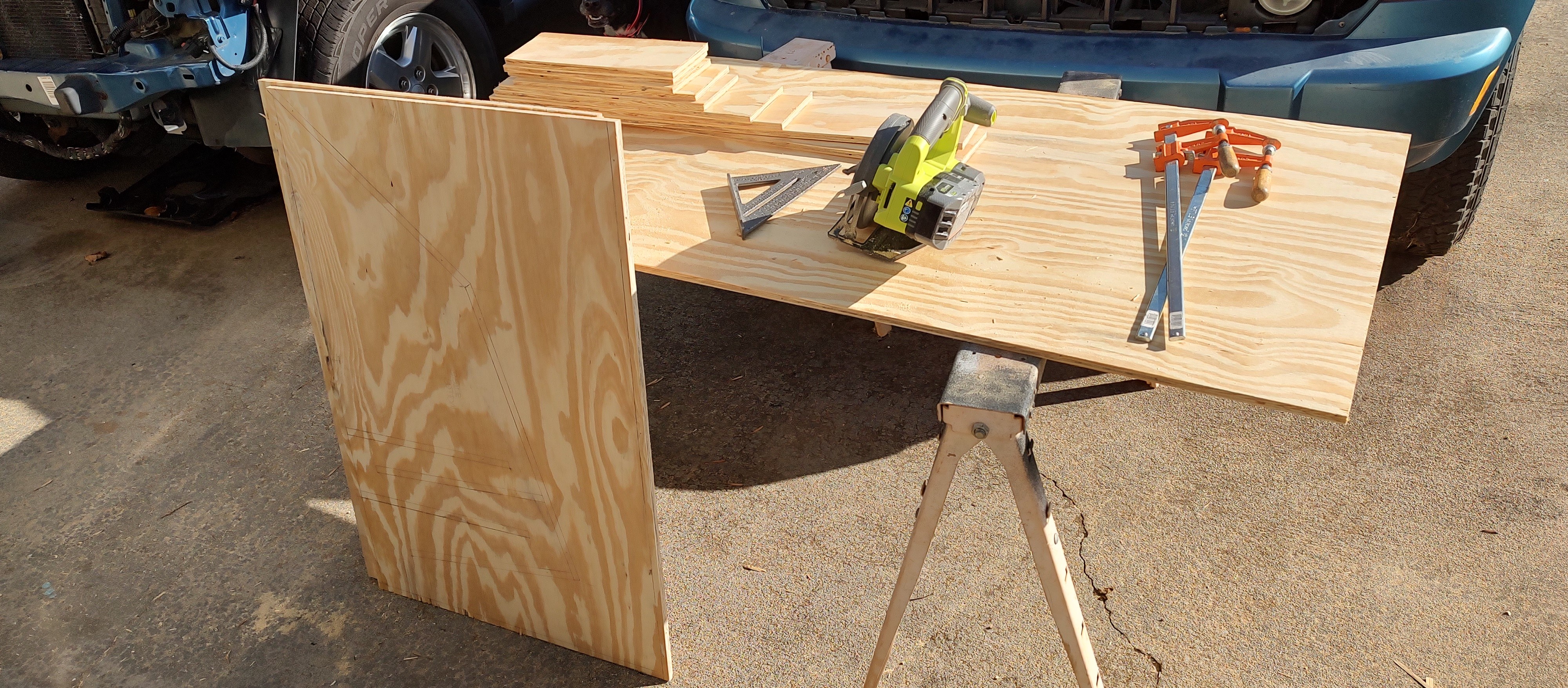

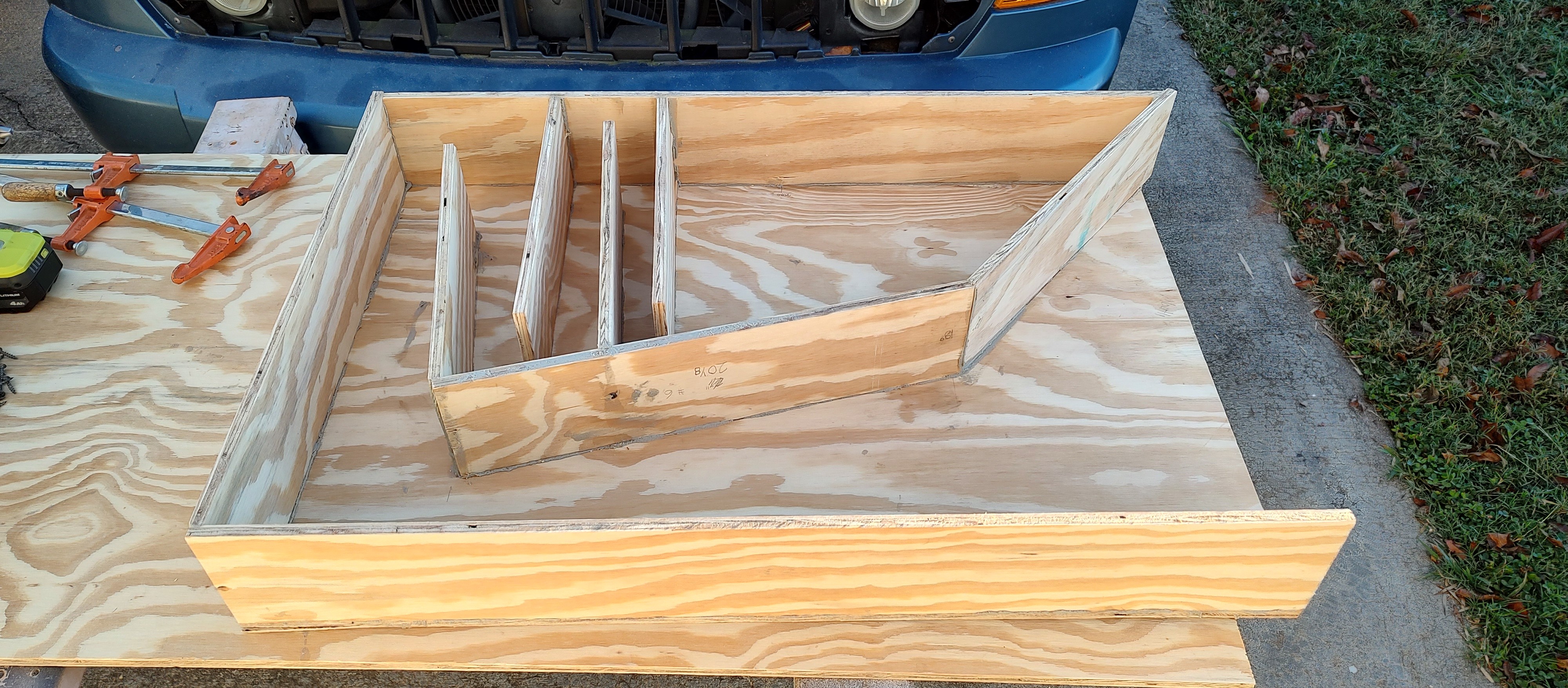

This is build with some unused 1/2" plywood I had. 5" side panels and using the Dayton Audio LS10-44 from the plans. I specifically chose the DA LS10-44 for the DVC(dual voice coil). I am using the JBL DSP4086 amplifier which is a full active 8 channel amplifier with 40 watts per channel. The 7th and 8th channel can be configured for low voltage to send a signal to a 2 channel or mono amplifier if desired but I'm going to try the 40 watts x 2 for the speaker. If that does not get me enough power I'll add the second amplifier easy enough.
Bills plans were excellent to follow and once I got started things progressed quickly. Started Saturday morning with cutting and drawing on the top and bottom panel as well as cutting to length the side panels with the angles for good fitment. By that night I had the bottom panel with all the side panels glued into place as seen in the pic. I did use some screws to temporarily hold some of the panels in place and all those were removed Sunday morning. This is good practice for the long term box to be built with Baltic Birch and stained gray. With this box going together so quickly I will probably also try one with MDF as I can get it free.

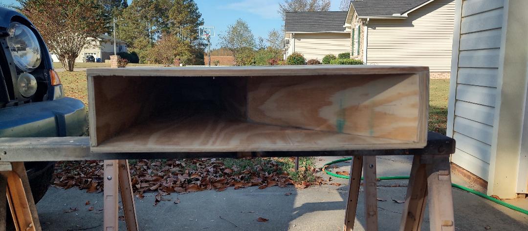

#3 Post by mpm17 »
And the speaker bracing

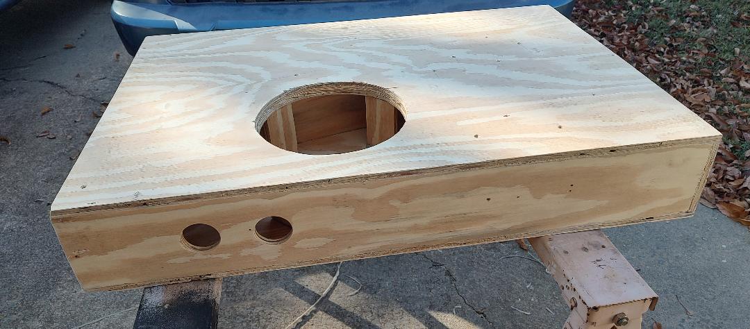

Finished assembling and sanded it some. I will fix the screw holes, paint the mouth and cover the rest in gray carpet after testing. Testing will include what's recommended in the plans and putting it in my daughters SUV. She has a sealed box with a 10" Rockford Fosgate. I suspect she will want to trade.

Coming down the home stretch. Looking pretty good. It does look like you may have missed a detail in the plans to inlay the driver. But, that won't change performance at all. I'm excited to hear about your impression!
