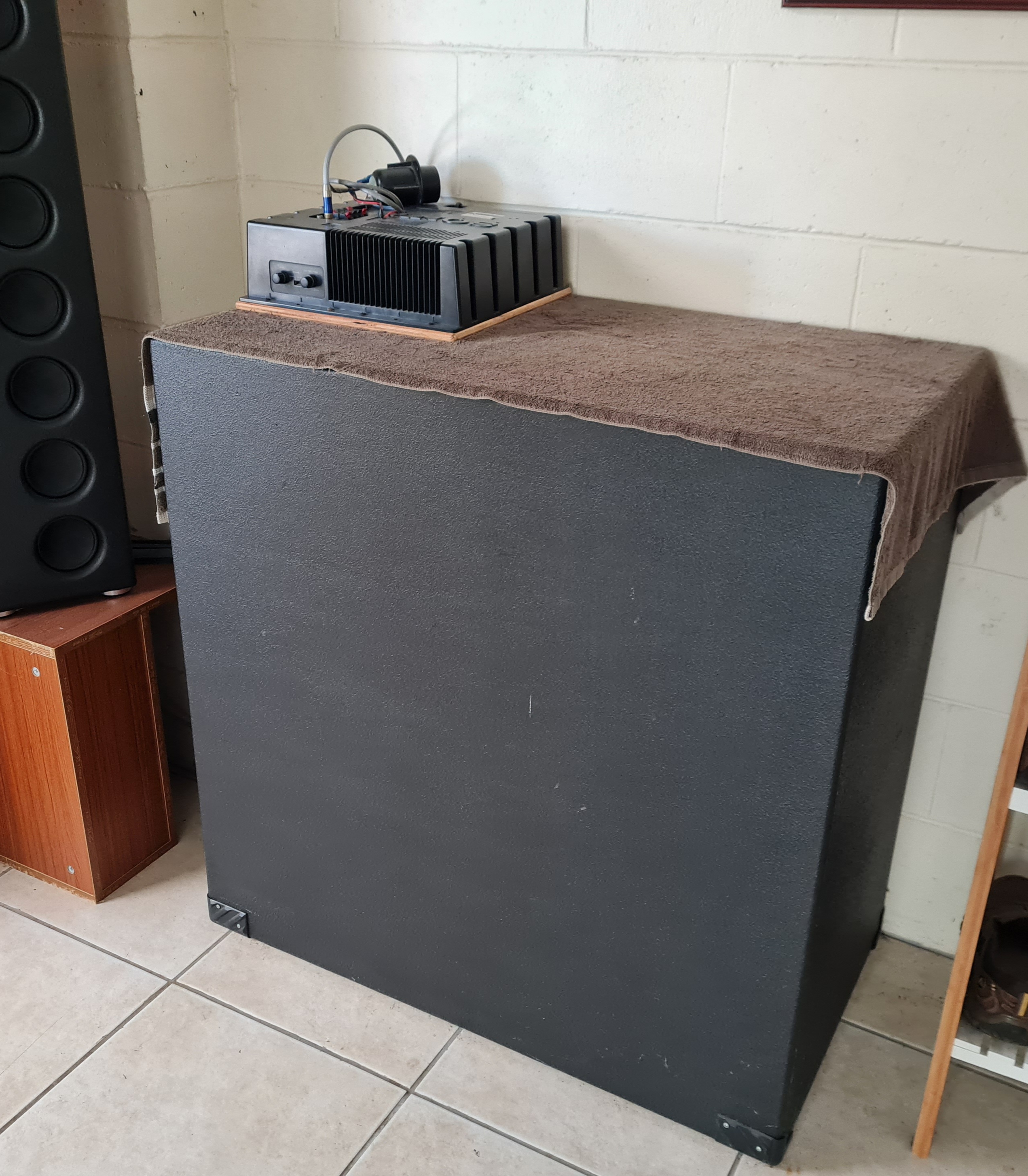

Wicked man! Hey there's a 20" THT here l wish you could feel, the thing has proper grunt! It's LAB15 loaded which has only around 20L more VAS than your driver..
I don't think you'll be disappointed at any width in a normal sized room with the THT personally.
