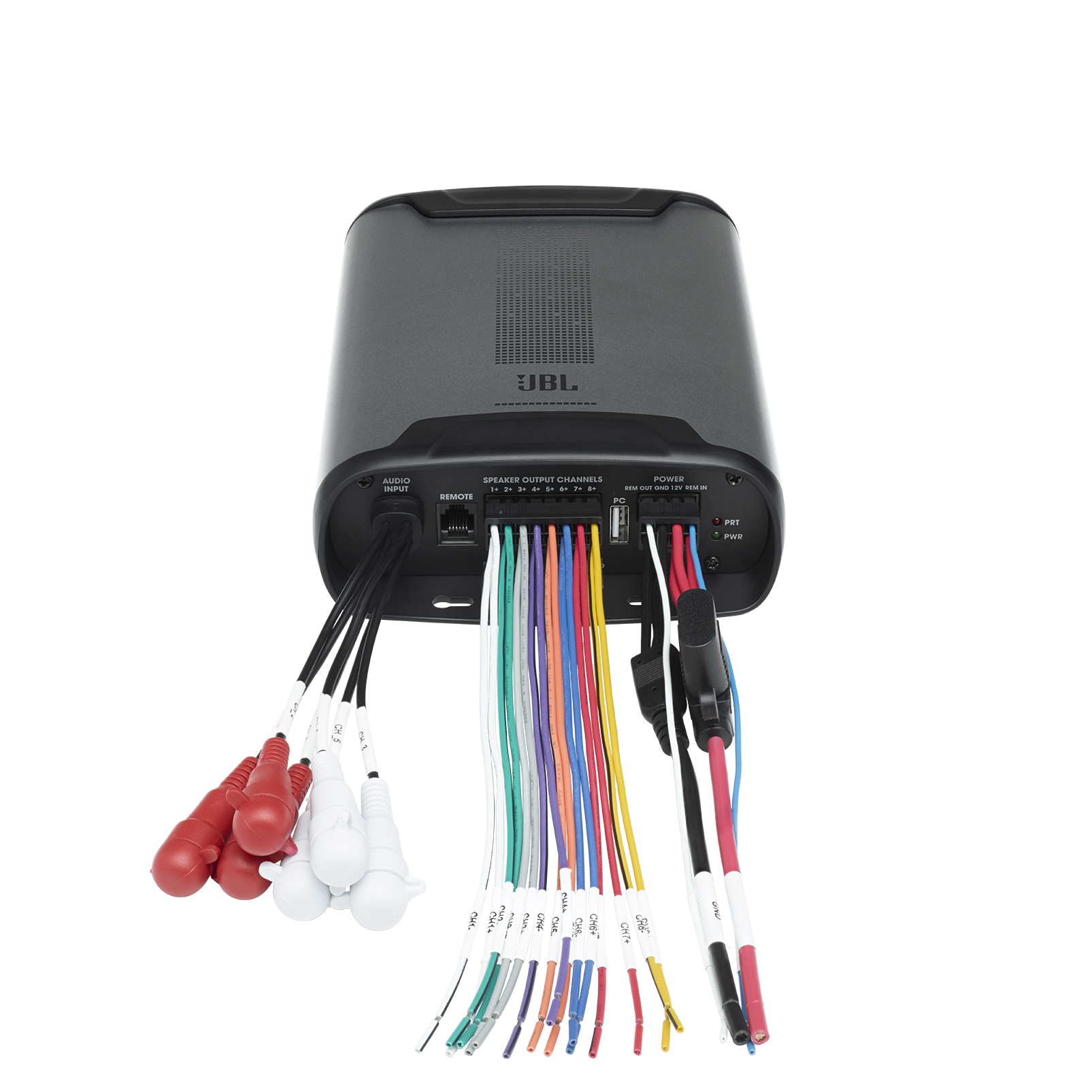

I have started building a truck tuba using one of the recommended Dayton Audio LS10-44. The truck tuba will be seven(7) total inched thick. This will go in my Jeep Liberty lying flat in the hatch area strapped down for safety. My front stage amplifier is the JBL DSP4086 using six of the eight channels. It's full DSP 8 channel amp at 40 watts per channel in a 4ohm load. A subwoofer in this system would usually have its own amplifier that would get its low level signal from the 7th and 8th channel on the JBL amplifier. It designed that way specifically so you can use it at 40 watts/channel or low level signal. My thoughts are since tuba subs are so efficient would the 7th and 8th channel at 40 watts each drive the dual voice coil speaker enough to skip the second amplifier? If my math is correct that would be 80 watts total :D. Both channels can be driven exactly the same so no concerns with a left and right signal. Its still a mono signal. You cannot bridge the channels so driving each voice coil at 4 ohms is the most you can get out of the amplifier in this case.
I do not usually listen at loud levels. Just occasionally cranking it with Rush. I'm not concerned with ultra low frequency reproduction so normally nothing below 40Hz. Crossover to the front stage will be in the 60 to 70Hz range. Crossover slope can be whatever it needs to be thanks to the DSP abilities.

...would the 7th and 8th channel at 40 watts each drive the dual voice coil speaker enough to skip the second amplifier?... ...I do not usually listen at loud levels...
Give it a shot. Peak potential volume would only be down 3-4dB compared to running it with a 150-200 watt amplifier. 3-4dB is a noticeable difference. But, just barely noticeable.
